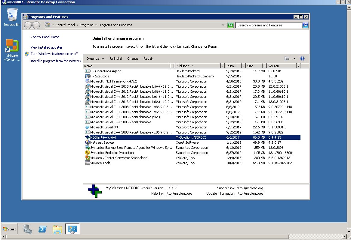

# WINDOWS.CFG - SAMPLE CONFIG FILE FOR MONITORING A WINDOWS MACHINE
# NOTES: This config file assumes that you are using the sample configuration
# files that get installed with the Nagios quickstart guide.
# HOST DEFINITIONS
# Define a host for the Windows machine we'll be monitoring
# Change the host_name, alias, and address to fit your situation
use windows-server ; Inherit default values from a template
host_name IA0CW007 ; The name we're giving to this host
alias IA0CW007 ; A longer name associated with the host
address 10.52.94.31 ; IP address of the host
# HOST GROUP DEFINITIONS
# Define a hostgroup for Windows machines
# All hosts that use the windows-server template will automatically be a member of thi$
define hostgroup{
hostgroup_name windows-servers ; The name of the hostgroup
alias Windows Servers ; Long name of the group
# SERVICE DEFINITIONS
# Create a service for monitoring the version of NSCLient++ that is installed
# Change the host_name to match the name of the host you defined above
host_name IA0CW007
service_description NSClient++ Version
check_command check_nt!CLIENTVERSION
# Create a service for monitoring the uptime of the server
host_name IA0CW007
service_description Uptime
check_command check_nt!UPTIME
# Create a service for monitoring CPU load
host_name IA0CW007
service_description CPU Load
check_command check_nt!CPULOAD!-l 5,80,90
# Create a service for monitoring memory usage
host_name IA0CW007
service_description Memory Usage
check_command check_nt!MEMUSE!-w 80 -c 90
# Create a service for monitoring C:\ disk usage
host_name IA0CW007
service_description C:\ Drive Space
check_command check_nt!USEDDISKSPACE!-l c -w 80 -c 90
# Create a service for monitoring E:\ disk usage
host_name IA0CW007
service_description E:\ Drive Space
# Create a service for monitoring F:\ disk usage
host_name IA0CW007
service_description F:\ Drive Space
# Create a service for monitoring H:\ disk usage
host_name IA0CW007

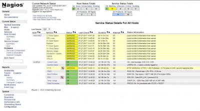

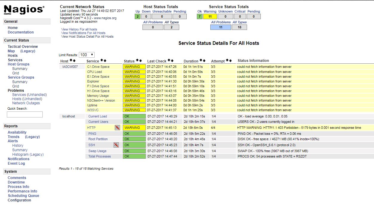

I have installed nagios client on the server. But still web interface shows it could not fetch info from the server.
I have added nagios server in the allowed host, and checked the first three options while installing the client as per this video https://www.youtube.com/watch?v=GxdPh9hk844
Please refer the attachment for the error.
Can we continue the same thread or u want me to open a new one?

Did you install the agent (nsclient++) on the Windows host? In order to monitor a remote host, you need to have an agent running on the remote host.
Re: nagios service restart failed.
I did install the agent.
Check the attachment please.
Go to a command prompt on your Nagios server and type
And post the result. This seems like a Windows Firewall issue.
