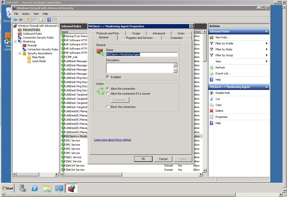

i forgot to mention that this client was installed when i was testing nagiosxi. I just added the new nagios core server in the "allowed hosts" in the nagios agent on ia0cw007. Do you think i need to do a re-install with only nagios core server.
I have added firewalls rule attachment. pls suggest how to proceed.

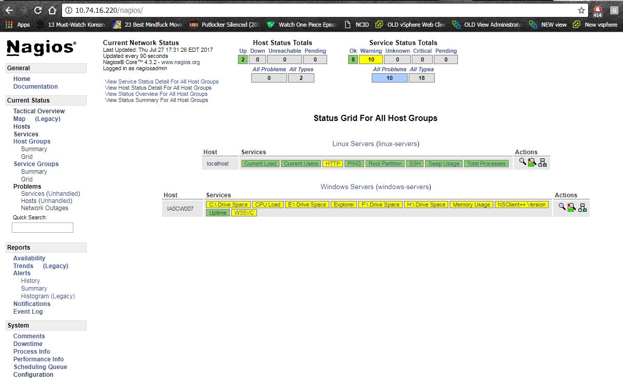

the services status is same.the services status is WARNING and status information is "could not fetch information from the server"

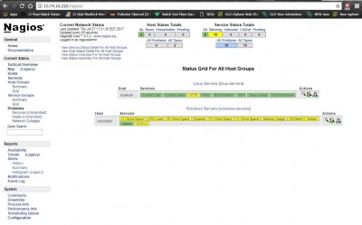

I see only Uptime is service is working on ia0cw007. pls check the attachment.
