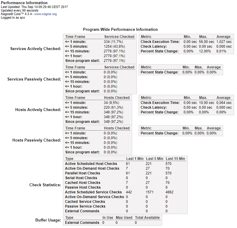

Postby alexpeeters » Thu Sep 14, 2017 2:32 am
Maybe you can an idea of our workload based on the performance information?

Postby bheden » Thu Sep 14, 2017 1:51 pm
Eeesh. I was hoping for way more stuff in there. That isn't a lot at all.
This may sound weird, but are you able to maybe compile the same version on say CentOS or Debian or something else? And migrate your entire infrastructure over to it and see if the bug persists?
We may have to move this to a github issue. It could very well be a bug, but there's still quite a lot of information I don't have.
