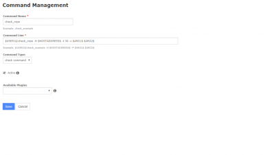

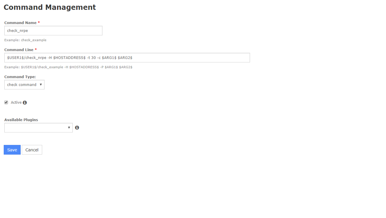

That's great! And remember to change your check nrpe command in XI to pass the certificates as well.
to
$USER1$/check_nrpe -A /usr/local/nagios/etc/ssl/ca/ca_cert.pem -C /usr/local/nagios/etc/ssl/nagios_server_certs/nagios_server.pem -K /usr/local/nagios/etc/ssl/nagios_server_certs/nagios_server.key -H $HOSTADDRESS$ -t 30 -c $ARG1$ $ARG2$
