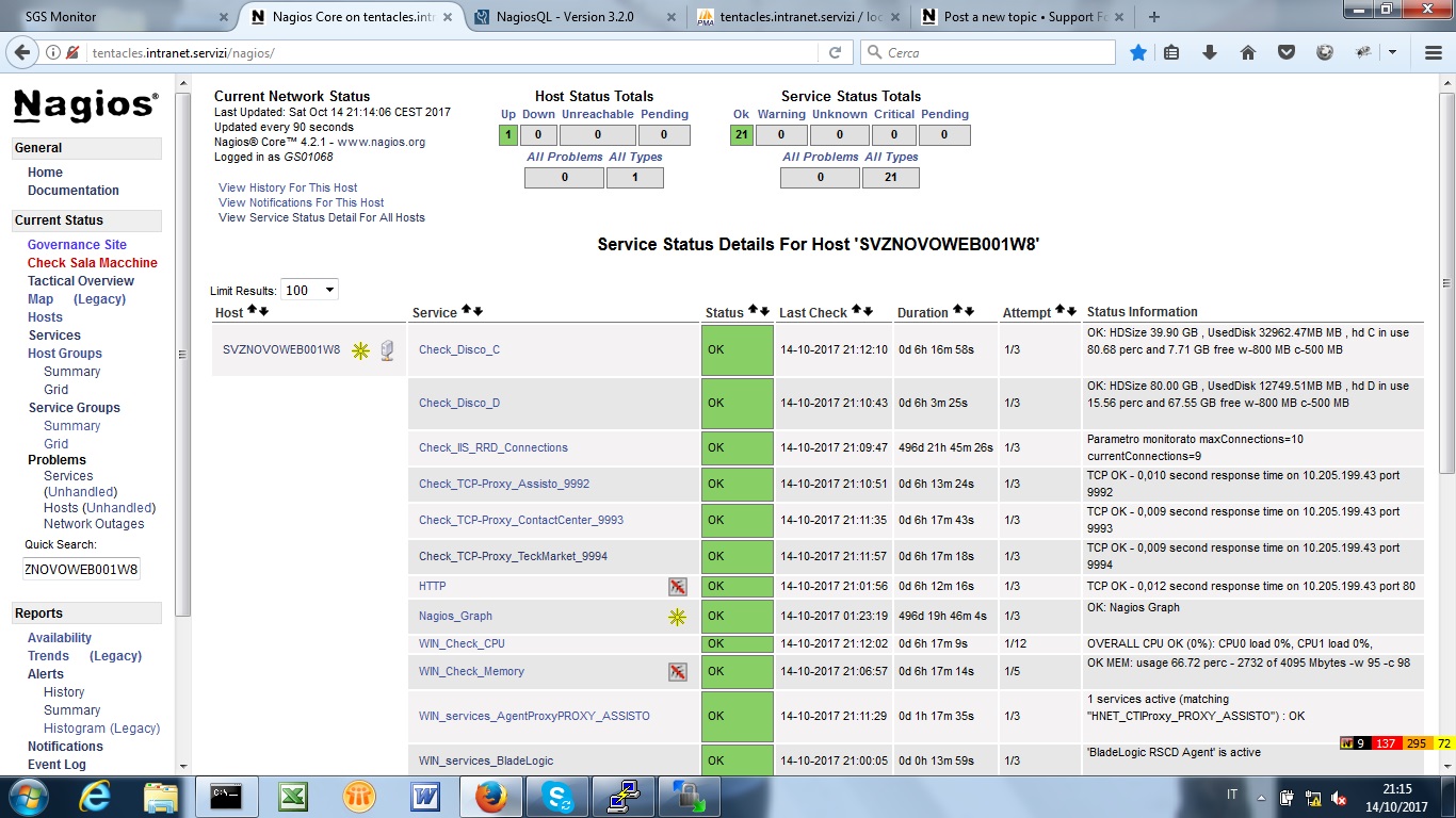

Hi
I'm using Nagios core 4.2.1
I disable notificaton in the services .cfg file but the cgi nagios interface doesn't show
the icon of notification disable
I attach the .cfg file and the printscreen of the web interface
Please could you help me to undertand where is the problem ?
Thanks for your help
Emilio

My guess is that there's a status.dat entry which is enabling notifications.
There's 2 places you can enable/disable notifications: Within the object's status entry (**/nagios/var/status.dat), and within the object's configuration entry (**/nagios/etc/some_config.cfg). I forget the default behavior and I'm not sure which one wins.

Are you trying to turn off notifications for the host SVZNOVOWEB001W8 or its services?
Have you also tried disabling them through the web UI?

Yes I try to disable notification to host and all his services from Web interface (Disable Notificaton for all services on this host)
and this operation works well (the disable notification icon appears and the notification are truely disabled)
Always I can re-enable the notification from the web interface and all works well

When you disable notifications from the web UI to should run and apply those configurations.
So,my question is,if you did this in the web UI and its worked fine do now wish to do manually from the terminal?
