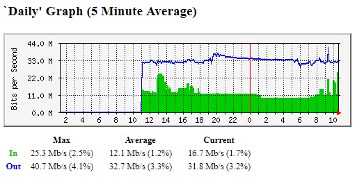

I want to monitor a port of a cisco switch, I'm using mrtg, I generate the .log file and I get to see the graph and the consumption correctly (Out 40.7 Mb / s (4.1%), In 25.3 Mb / s (2.5%)), The port in question is fiber optic with a speed of 1GB, therefore that is the limit.

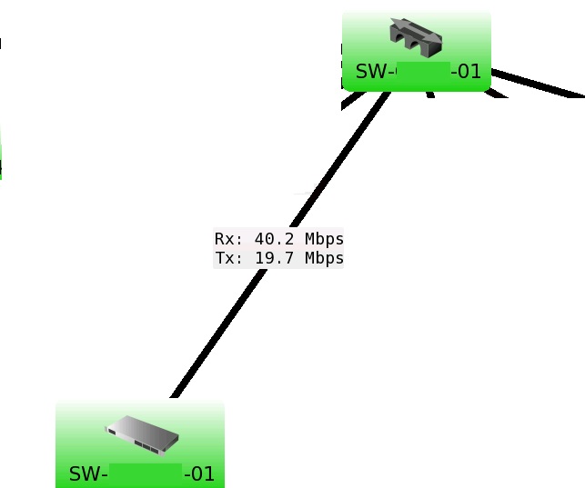

I need to be able to visualize the bandwidth of a network interface, the equipment is a cisco catalyst 2960 switch. Or maybe configure to show the option in real megaytes, I do not know why it shows so little in The Dude shows much more, or in the same mrtg it looks good. If there is another tool that I would like to recommend, but until now everything that probe did not work
