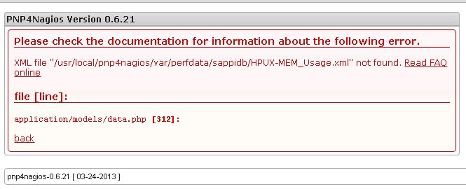

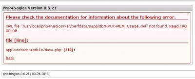

I am using pnp4 nagios for getting the historical data for the services configured for a particular server.How ever when i try to take the historical data for a particular service i am getting below error.
PNP4Nagios Version 0.6.21
Please check the documentation for information about the following error.
XML file "/usr/local/pnp4nagios/var/perfdata/sappidb/HPUX-MEM_Usage.xml" not found. Read FAQ online
Attaching the screenshot also for your reference.
Kindly let me know how to fix the same as i need to get the data for this service for the last one month.

Here is something interesting about the error.
Take a look at this article.
https://geekpeek.net/pnp4nagios-xml-file-not-found/

@kyang
Thank you for the reply.
i am attaching my plugin along with the reply.i have gone through the post but not sure what needs to be added in the script.
Can you please check the plugin and let me know what needs to be added additionally.
Regards,
RKJ
Regards,
RKJ

Re: Pnp4 nagios unable to display historical data for a serv
Hi rohithroki,
The plugin needs performance data parameters.
The example output from the article is what your plugin needs.
You could also take a look at our guidelines.
http://nagios-plugins.org/doc/guideline ... PERLPLUGIN
http://nagios-plugins.org/doc/guidelines.html#AEN200
'label'=value[UOM];[warn];[crit];[min];[max]
OK - Number of open files is 1592 | NumOpenFiles=1592;1900;2048;0;10000
