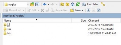

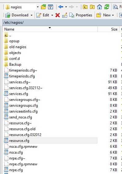

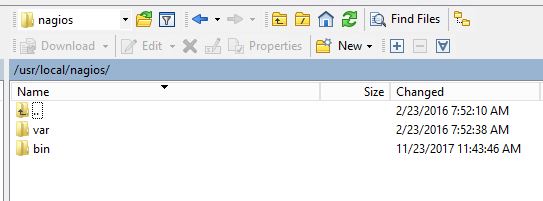

In the /usr/local/nagios i can see the following 2 Folders: Refer to the screenshot(Backup)
and i am taking the backup of the folder: Refer to the screenshot attached(Backup-1)
How to ensure that installation has been done without changing the default location? Because i didn't installed the Nagios and i am also new to Nagios.

What Nagios Version are you running? My guess is version 3?
Looks like yours may be installed a bit differently than the version I run which is 4.3.4.
Your config files are under /etc/nagios while mine are under /usr/local/nagios
This is what I see under my folder /usr/local/nagios
My main config files exist under the folder called "etc" and my host objects are in a folder under that called "objects"

- Support Tech
- Posts: 3457
Re: Backup of the Nagios Core
@amitgupta19, Looks like the main folder with all the configs on your system is /etc/nagios/. Have you considered spinning up Nagios Core on a Virtual machine? That way you could make system snapshots and revert any time.
