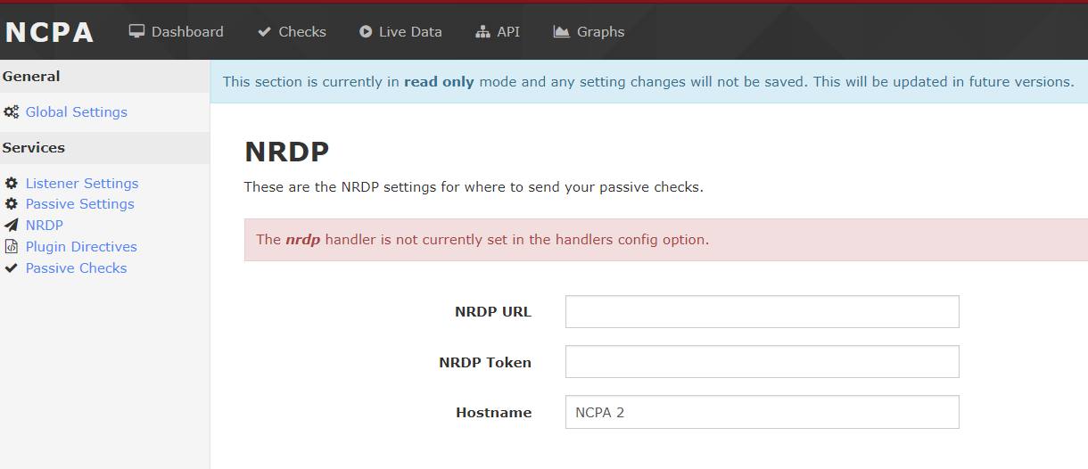

Postby cybergene » Thu Dec 14, 2017 9:18 am
Hi @npolovenko,
I still have access to Nagios Core Ui and it wasn't affected by running the commands for NRDP.
nagios Core system is:
Description:    Ubuntu 16.04.3 LTS
Release:        16.04
Codename:       xenial
I did a re-run of the commands on my system and it seems to work, I can see the NRDP UI and ran a couple tests.
Proceeding with the installation, I set up NCPA on a remote host and was able to log into the NCPA UI too (on the remote host).
In the UI, I'm sure how to set-up the communication between the NCPA and NDRP. I attached a screenshot of what I see in the UI.
Is there any instructions for NCPA to work with Nagios Core? I don't think this would work in Core (https://assets.nagios.com/downloads/nagiosxi/docs/Monitoring-Devices-Using-The-NCPA-Agent-And-Nagios-XI.pdf)

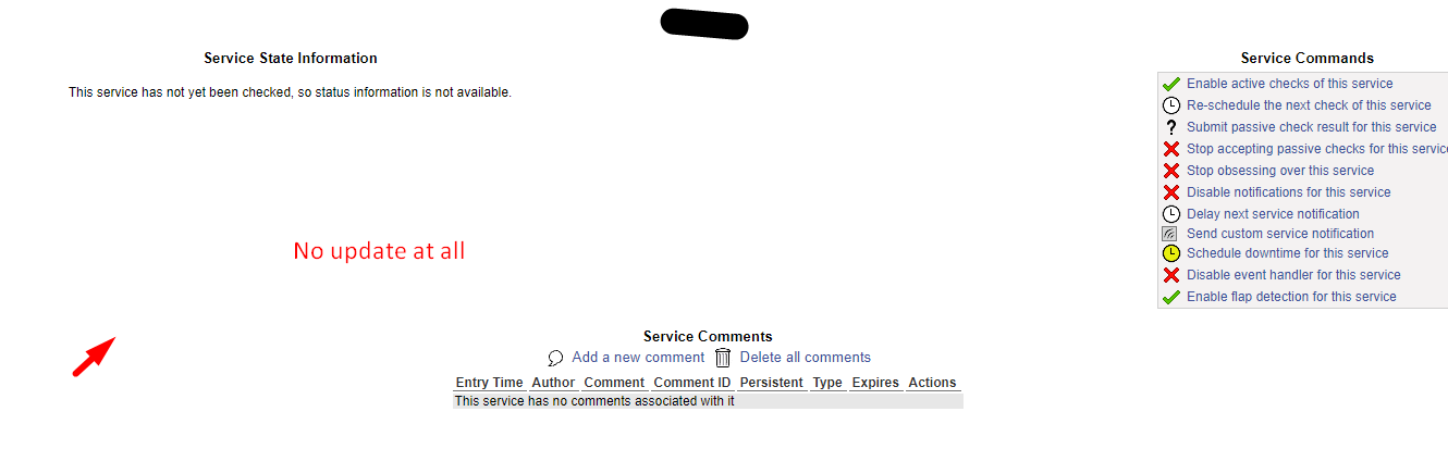

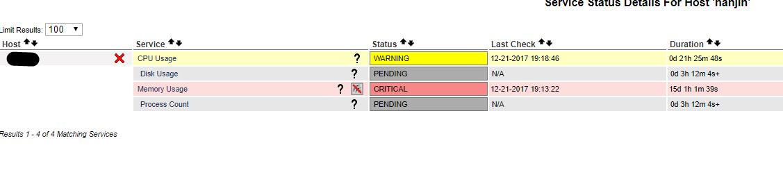

Postby cybergene » Fri Dec 22, 2017 8:38 am
Hi @npolovenko,
I did the steps in the manuals and now I have the config on Nagios and the remote host.
I don't see any errors in the log file. Maybe because I already added the hostname and the services that matches with the remote host?
Since yesterday, I haven't seen any changes in the status of any of the service on that server except the ones I was testing.
I'm going to check the config again maybe I missed something. I'm wondering if there a way to do a test from the remote host , like we do for the Active checks...

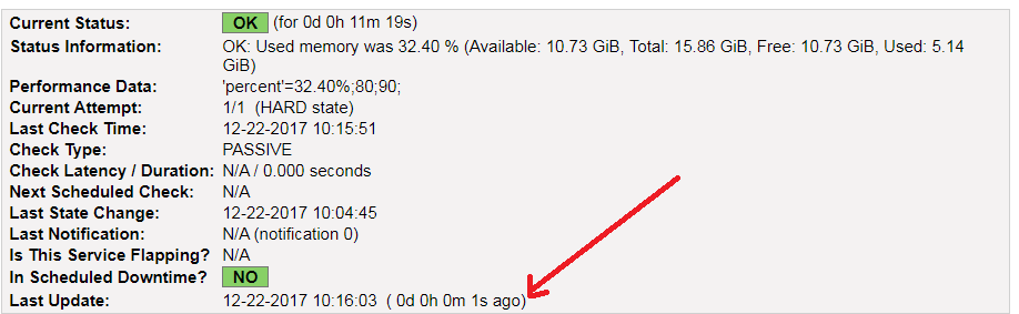

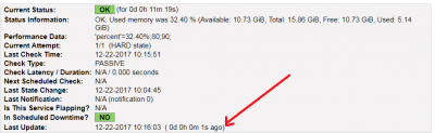

Postby cybergene » Fri Dec 22, 2017 11:54 am
Thanks for the help @npolovenko
npolovenko wrote:@cybergene,
Did you use this tutorial to add a host and services definitions?If not I'd like to see how you defined them.
https://support.nagios.com/kb/article/nrdp-passive-host-and-service-definitions-762.html
Yes, and it is exactly as the tutorial.
If you added definitions correctly then yeah, you wouldn't see errors in the nagios.log file. But when you click on defined service checks in Core web interface, is the last update time changing at all?
No,no change at all since I set-up the server, check the attached screenshots. The colors are from manual tests.
