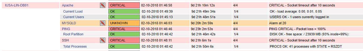

Postby shamrozkadiwal » Sat Feb 03, 2018 2:28 pm
I have setup "check_http" "check_ssh"to monitor apache and ssh service on the server, but I have been getting CRITICAL - Socket timeout after 10/20/30 seconds error for both plugins. I have tried to increase the timer but still getting the same error. I also check the firewall and both services have been added.
Nagios Core is running on Centos 7
NRPE is running on Ubuntu
[root@dj-mon ~]# /usr/local/nagios/libexec/check_http -H 10.167.176.43
CRITICAL - Socket timeout after 10 seconds
[root@dj-mon ~]# /usr/local/nagios/libexec/check_http -H 10.167.176.43 -S
[root@dj-mon ~]# /usr/local/nagios/libexec/check_http -H 10.167.176.43 -S -t 20
CRITICAL - Socket timeout after 20 seconds
[root@dj-mon ~]# /usr/local/nagios/libexec/check_http -H 10.167.176.43 -S -p 443
[root@dj-mon ~]# /usr/local/nagios/libexec/check_http -H 10.167.176.43 -S -p 80
[root@dj-mon ~]# /usr/local/nagios/libexec/check_http -H 10.167.176.43 -S -p 8080
CRITICAL - Socket tieout after 10 seconds
[root@dj-mon ~]# /usr/local/nagios/libexec/check_http -H 10.167.176.43 -N -p 80
[root@dj-mon ~]# /usr/local/nagios/libexec/check_http -H 10.167.176.43 -N -p 80 -t 1
CRITICAL - Socket timeout after 1 seconds
[root@dj-mon ~]# /usr/local/nagios/libexec/check_http -H 10.167.176.43 -N -p 80 -t 10
[root@dj-mon ~]# /usr/local/nagios/libexec/check_http -H 10.167.176.43 -N -t 30
CRITICAL - Socket timeout after 30 seconds
[root@dj-mon libexec]# /usr/local/nagios/libexec/check_ssh -H 10.167.176.43
[root@dj-mon libexec]# /usr/local/nagios/libexec/check_ssh -H 10.167.176.43 -t 30

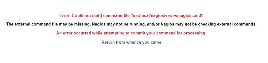

Postby shamrozkadiwal » Fri Feb 09, 2018 1:45 pm
I saw this error when I tried to run "Re-schedule the next check of this service". I don't know this could be a help.

Postby kyang » Fri Feb 09, 2018 3:51 pm
Could you create a new thread for that issue?
That way we are not troubleshooting 2 errors in one thread.
It would be less confusing for us techs as well. Thank you!
