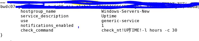

Re: UPTIME Threshold
amitgupta19 wrote:Please refer to my first attachment, UPTime Definition.
you had this
check_command        check_nt!UPTIME -l hours -c 5
I proposed this
check_command        check_nt!UPTIME!-l hours -c 5

amitgupta19
Posts: 286
Joined: Fri Sep 08, 2017 5:53 am
Post by amitgupta19 »
Thanks for pointing this out:
PFA screenshot from services.cfg, hope this time command should be OK.
But still no Alert generated.
Did you read the doc I sent?
Your config that you are showing doesn't have a contact specified to alert

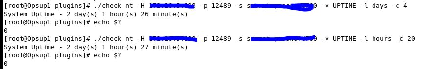

Posts: 13587
You will see an alert when you have an exit code of 2 (CRITICAL). Test your check again from the command line to see what is the exit code. Here's an example of exit code of 0 (OK), when I use "20" hours as a critical threshold, and exit code of 2 (CRITICAL), when I use "30" hours as a critical threshold:
[root@main-nagios-xi libexec]# ./check_nt -H x.x.x.x -s password -p 12489 -v UPTIME -l hours -c 20
System Uptime - 1 day(s) 1 hour(s) 30 minute(s) |uptime=25
[root@main-nagios-xi libexec]# echo $?
0
[root@main-nagios-xi libexec]# ./check_nt -H x.x.x.x -s password -p 12489 -v UPTIME -l hours -c 30
2

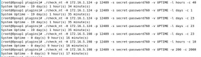

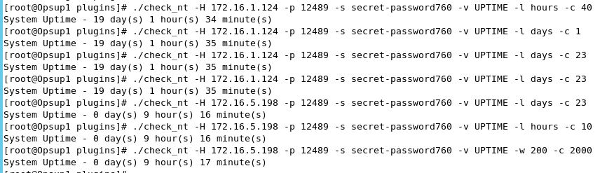

amitgupta19
Posts: 286
Please find here with the Output of the manual command
It is giving 0 in both the cases.
