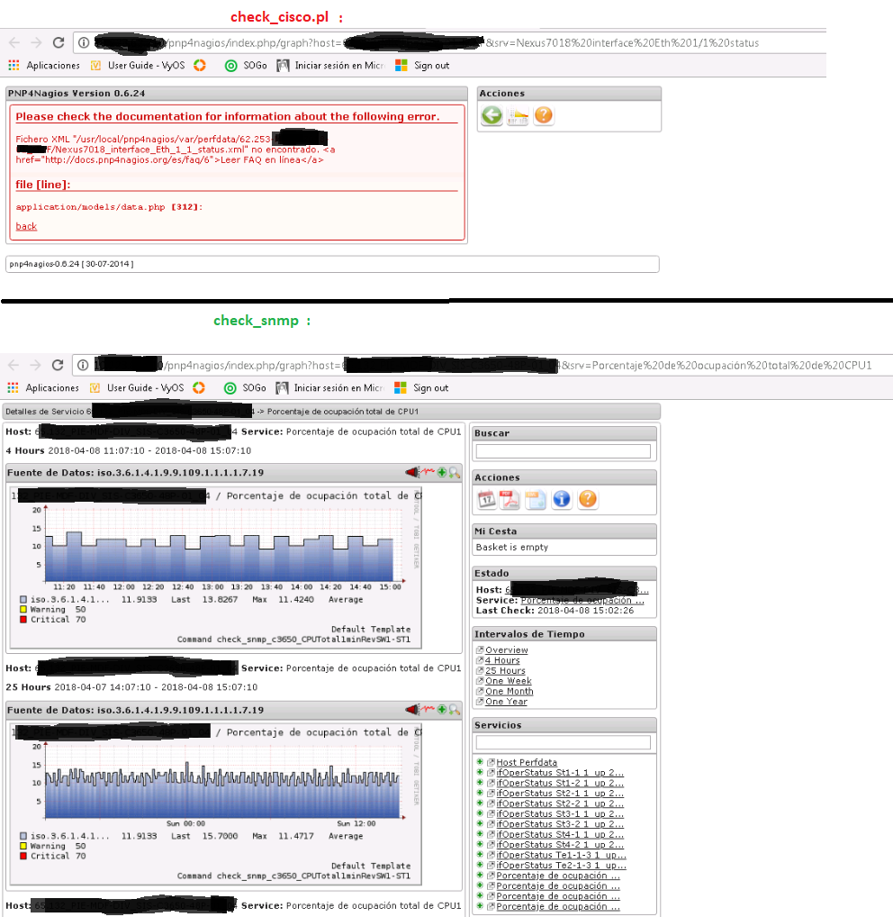

I am trying to graph the data using pnp4, I using check_cisco but do not display graphs,
with other plugins if it works as with check_snmp

Performance data empty:
[root@localhost ~]# ls -l /usr/local/pnp4nagios/var/perfdata/62.252-MICH-7018-02_MDF/
total 756
-rw-rw-r-- 1 nagios nagios 768224 Apr 8 15:07 _HOST_.rrd
-rw-rw-r-- 1 nagios nagios 2653 Apr 8 15:07 _HOST_.xml
[root@localhost ~]#
It works with check_snmp command:
[root@localhost ~]# ls -l /usr/local/pnp4nagios/var/perfdata/65.132_PIE-MDF-DIV_SIS-C3650-48P-01_04/
total 6076
-rw-rw-r-- 1 nagios nagios 768224 Apr 8 15:10 _HOST_.rrd
-rw-rw-r-- 1 nagios nagios 2758 Apr 8 15:10 _HOST_.xml
-rw-rw-r-- 1 nagios nagios 384952 Apr 8 15:09 ifOperStatus_St1-1_1_up_2_down.rrd
-rw-rw-r-- 1 nagios nagios 2361 Apr 8 15:09 ifOperStatus_St1-1_1_up_2_down.xml
-rw-rw-r-- 1 nagios nagios 384952 Apr 8 15:02 Porcentaje_de_ocupación_total_de_CPU1.rrd
-rw-rw-r-- 1 nagios nagios 2470 Apr 8 15:02 Porcentaje_de_ocupación_total_de_CPU1.xml
[root@localhost ~]#
[root@localhost /]# ls -l /usr/local/pnp4nagios/var/perfdata/65.153_XXXXXXXXXXXXX/
total 1136
-rw-rw-r-- 1 nagios nagios 768224 Apr 8 01:29 _HOST_.rrd
-rw-rw-r-- 1 nagios nagios 2709 Apr 8 01:29 _HOST_.xml
-rw-rw-r-- 1 nagios nagios 384952 Apr 8 01:29 Temperatura.rrd
-rw-rw-r-- 1 nagios nagios 2232 Apr 8 01:29 Temperatura.xml
But not work with check_cisco :shock: :shock:
[root@localhost /]# ls -l /usr/local/pnp4nagios/var/perfdata/62.252XXXXXXXXXXXXX/
total 756
-rw-rw-r-- 1 nagios nagios 768224 Apr 8 01:26 _HOST_.rrd
-rw-rw-r-- 1 nagios nagios 2653 Apr 8 01:26 _HOST_.xml
[root@localhost /]#

Thanks for sharing a rather comprehensive chunk of information.
Assuming you are using this version of check_cisco.pl:
https://exchange.nagios.org/directory/P ... rs/details
This plugin does not appear to provide performance data. In other words, the plugin would need to be altered to provide performance data in order for pnp4nagios to graph it. This is a limitation of the check_cisco.pl plugin; Not Nagios Core or pnp4nagios. The plugin is just making simple snmp walk and get calls, so you could probably pull the particular OIDs out and configure them with check_snmp as an alternative. This would require a bit of research and knowledge of SNMP.

As @mcapra pointed out you would need to either add performance data to the plugin or use a different plugin.

I am now using the check_cisco plugin, This works!
