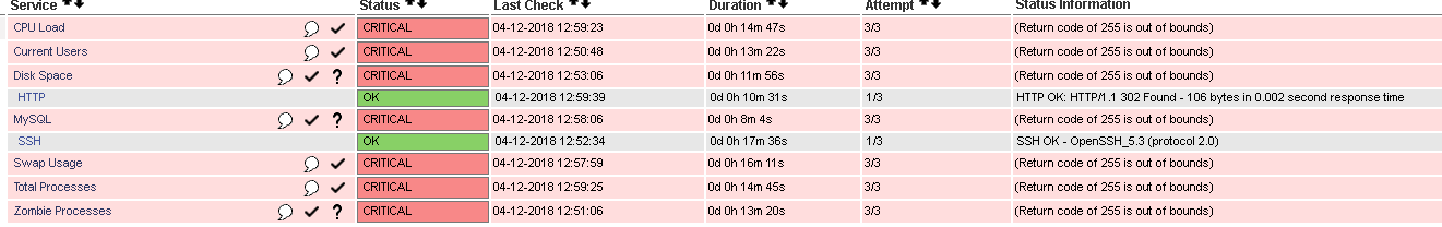

Postby ebp12100 » Wed Apr 11, 2018 2:58 pm
I'm setting up a Linux server running CentOS 6.9 that is being recognized on the Nagios Core web interface, but the services for this new target client are throwing service alerts. The error shown for those services is in the subject line of this topic: (Return code of 255 is out of bounds)
I'm leaning toward it being some type nrpe issue but have researched that piece but nothing I've tried has worked thus far. If someone is familiar with this alert could you point me toward a solution?

Postby ebp12100 » Thu Apr 12, 2018 12:04 pm
I've attached a screen capture of what I'm seeing on the web interface
