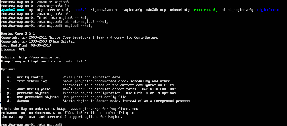

When you say "binary" are you referring to the primary Nagios config folder (e.g. Nagios or Nagios3)? I believe the existing one is currently located in /etc/nagios3 directory. I have attached a screenshot of how i'm verifying the version and what it looks like.
I did follow the article you referenced but still no luck getting to upgraded 4.3.4 version. Is it possible I ran the install from the wrong directly and it didn't overwrite my existing installation files? Please let me know if there is any more information you require.

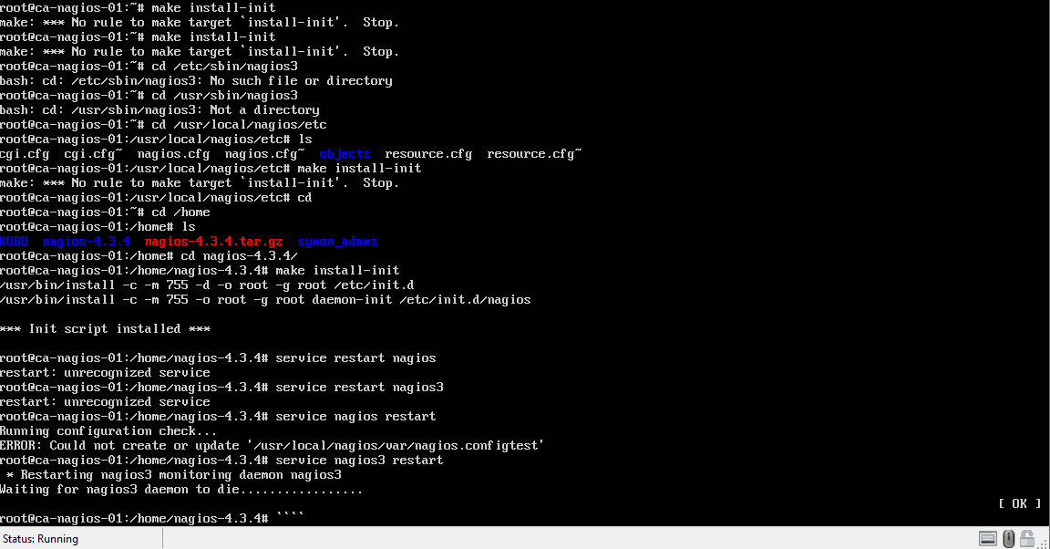

I ran the make install-init command from the nagios-4.3.4 folder and it seemed to work. If I run that command from another directory it says "No rule to make target 'install-init'. Stop."
I then restart the Nagios (in my case nagios3) service. (see attached screenshot).
Should I proceed using the last command to copy over the config to another directory? Is that what you think the issue could be or is there something else i'm missing in the upgrade steps? It's misleading since all appeared normal without errors when running the install commands.

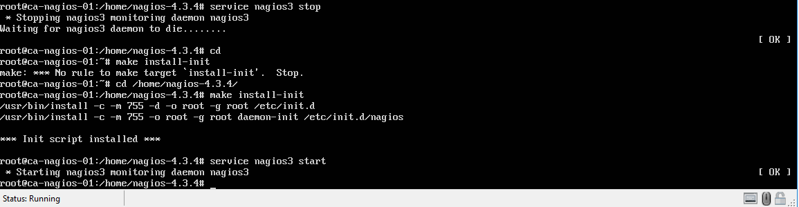

Postby mtripodi » Tue Apr 17, 2018 2:30 pm
I stopped the Nagios service using service nagios3 stop then ran the make install-init command then started the Nagios service again.
It still only runs successfully when run the command from the 4.3.4 installer folder. Did I run that correctly?

Postby scottwilkerson » Tue Apr 17, 2018 2:38 pm
you are close..
Just run the following
chkconfig nagios3 off
chkconfig nagios on
and stop using nagios3, your service name is now called nagios
such as
service nagios restart
Posts: 13442
