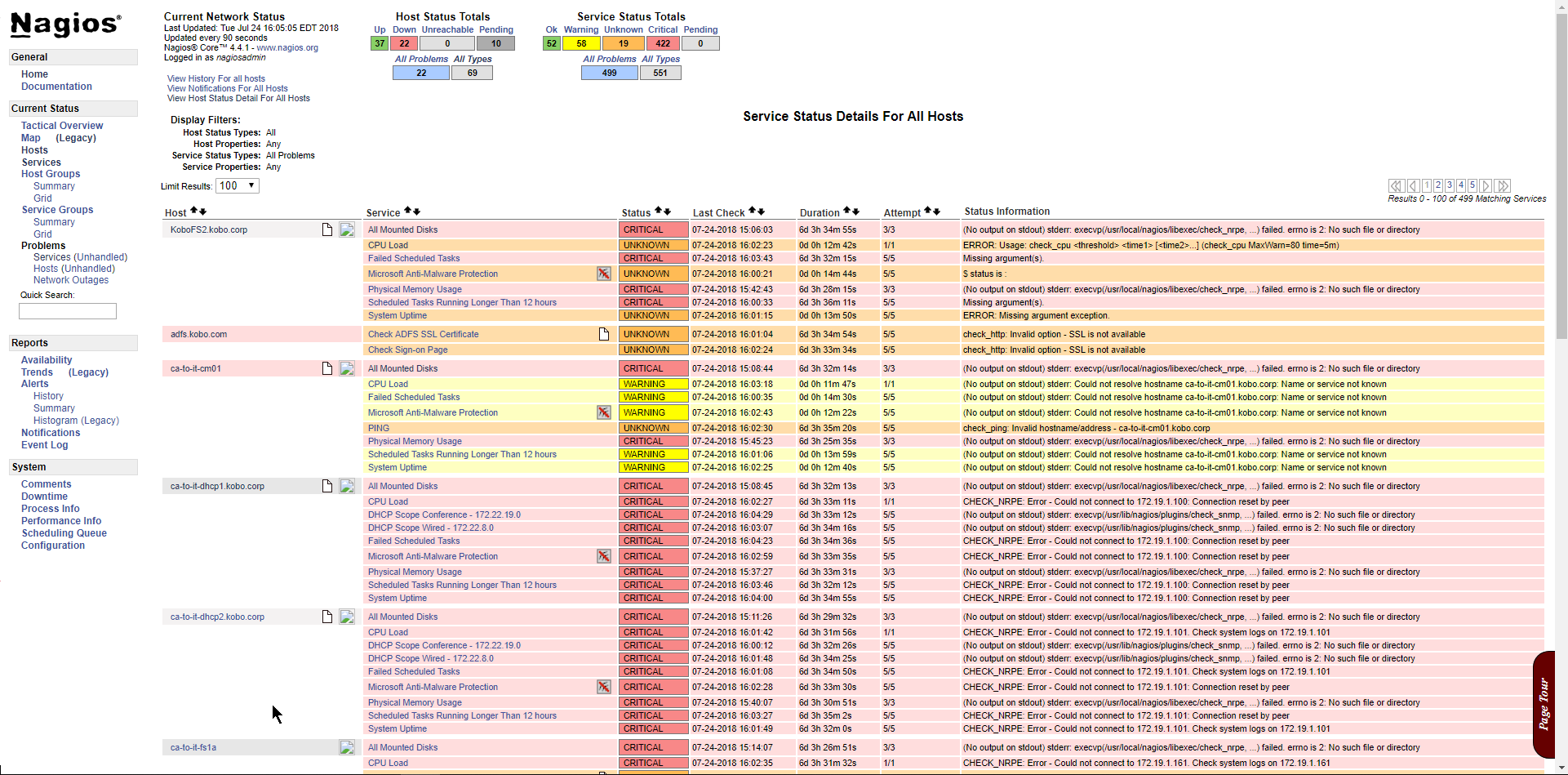

I was able to successfully re-compile and installed NRPE plugin which I realized I did not have. The errors have changed, however I am still receiving some of these errors still:
(No output on stdout) stderr: execvp(/usr/local/nagios/libexec/check_nrpe, ...) failed. errno is 2: No such file or directory
I believe the remaining errors are mostly due to the fact that this new Nagios server is not configured to run the particular service checks I have configured yet. I will sort that out once it's been moved into our production environment.
In the meantime, can you please look at the remaining errors in my attached screenshot and let me know if anything stands out. Perhaps I missed other installs/config. Thanks.
