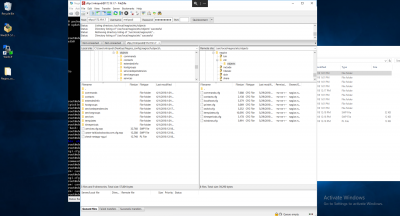

I was able to successfully disable the firewall and connect via SFTP on one of my VM's running Centos 7. However, still unable to connect to the other VM running Ubuntu 16.04 after disabling the firewall. The CTRL+C and CTRL+V commands are also not working for copying over the config to the new server (VM). Can I use an SCP command instead for the Ubuntu VM?
For the Centos 7 VM, I have attached a screenshot of the folder directories from my existing config versus the current Centos7 config directories. As you can see I have my files grouped in folders to easily manage. If I copy all these folders into the /usr/local/nagios/etc/objects/ directory will it impact anything or will the checks continue to work? Just curious whether this folder structure will still be accepted.
