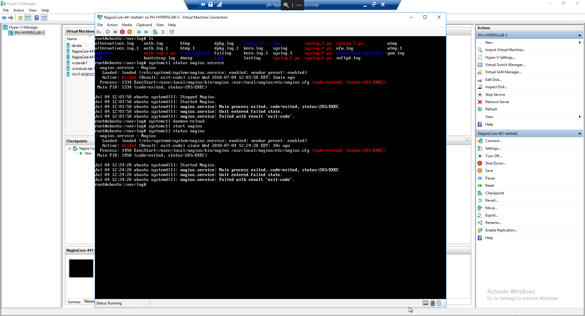

Postby mtripodi » Wed Jul 04, 2018 11:30 am
Hi there,
I noticed Nagios Core 4.4.1 was recently released. Successfully updated both Ubuntu and CentOS 7 VM. However, i'm encountering 2 issues preventing me from further testing:
1. I moved my old configuration to the following locations on both VM's but when logging into the web interface I don't see any of my hosts or services listed. I restarted the services several times, anything i'm missing?
Nagios config on Centos Nagios config: /local/nagios/etc/objects
Nagios config on Ubuntu 16.04: /usr/local/nagios/etc/objects
2. After the upgrade on my Ubuntu 16.04 VM from 4.3.4 to 4.4.1 i'm no longer able to run the nagios.service. I have restarted the services, VM and ran latest updates. I continue to see the error in my attached screenshot. Please HELP!
mtripodi
Posts: 49
Postby npolovenko » Thu Jul 05, 2018 4:47 pm
@mtripodi, Please run the following command to verify the configuration:
Let me know if it returns any errors.
npolovenko

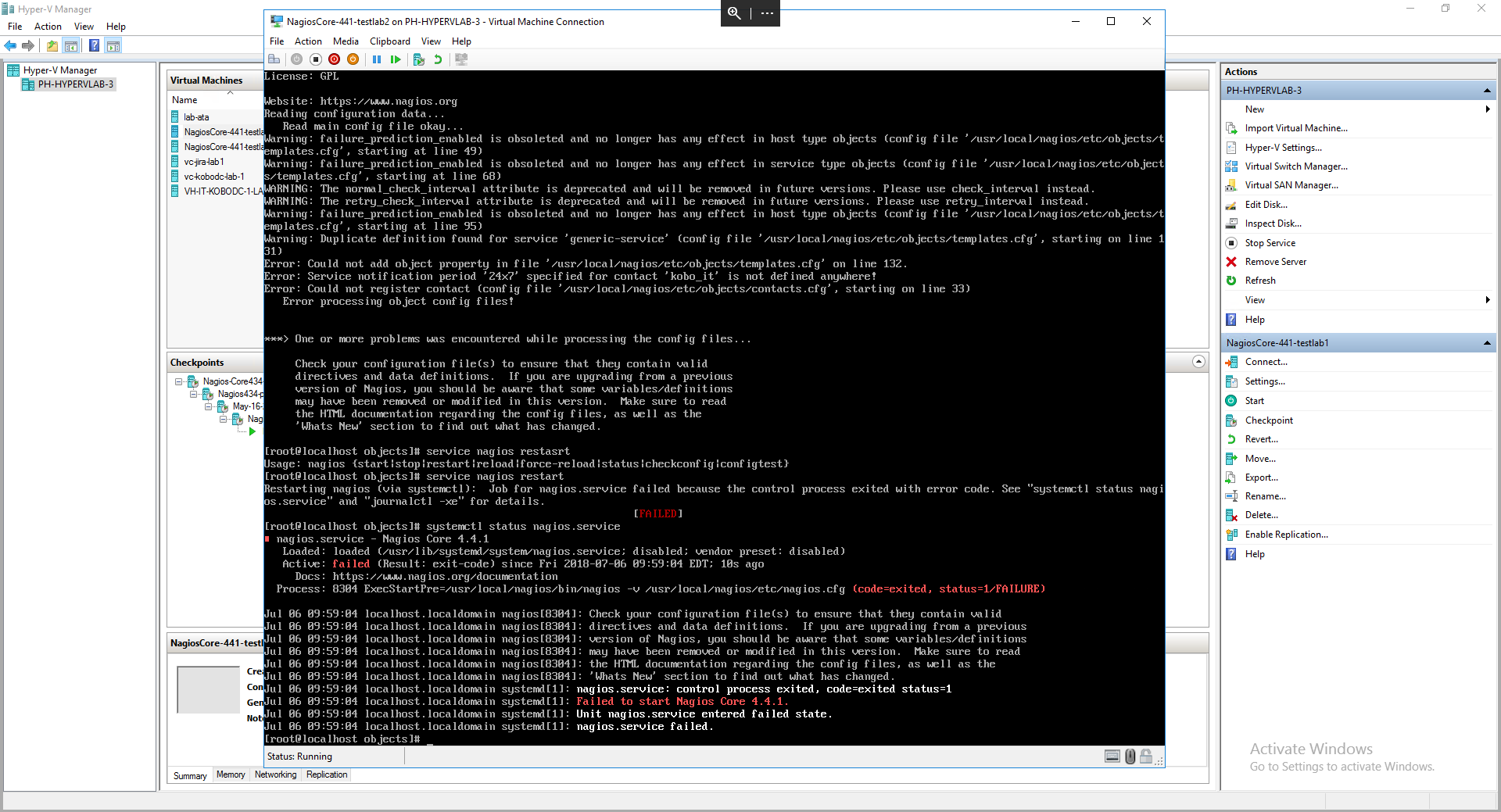

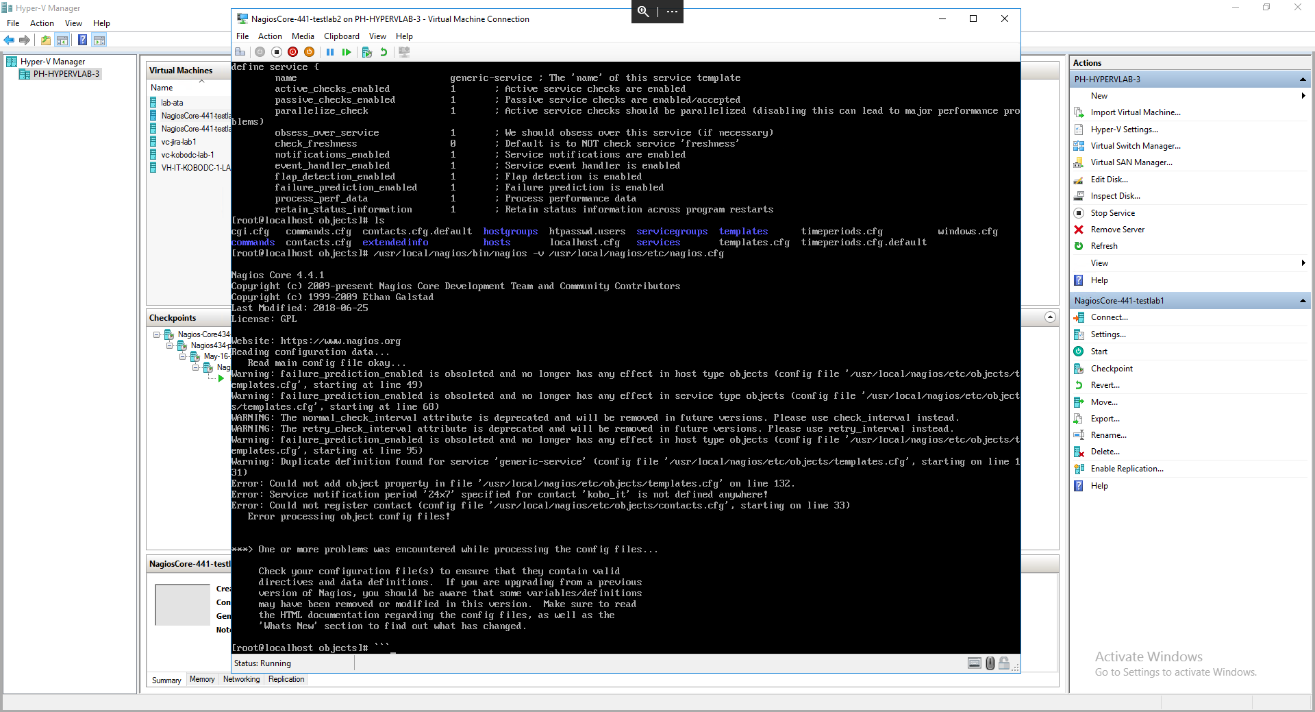

Postby mtripodi » Fri Jul 06, 2018 9:00 am
Long story short, I had my Nagios server up and running, however I did not see the hosts/service checks. I sent a custom notification via the web console but needed it to arrive in our mailbox. So I updated the contacts.cfg file with my own from our current server. Then ran the command to verify the config and Nagios complained it didn't have the "service notification period" definition.
This is defined in one of my templates. I noticed Nagios is only looking at the default templates.cfg and not my other template config files so I decided to copy/paste a couple of my host definitions into the one templates.cfg file. Now when running the command to verify the config I get the following, see screenshot attached. I also attached a screenshot of the error I get when attempting to start the Nagios service. Not sure if it's related.
I may have messed up the configuration further. Please HELP!
mtripodi
Posts: 49
Postby lmiltchev » Fri Jul 06, 2018 1:43 pm
Can you show us the code around line 132 in the templates.cfg file?
According to the error, you are missing a timeperiod definition... Is "24x7" defined in the timeperiods.cfg?

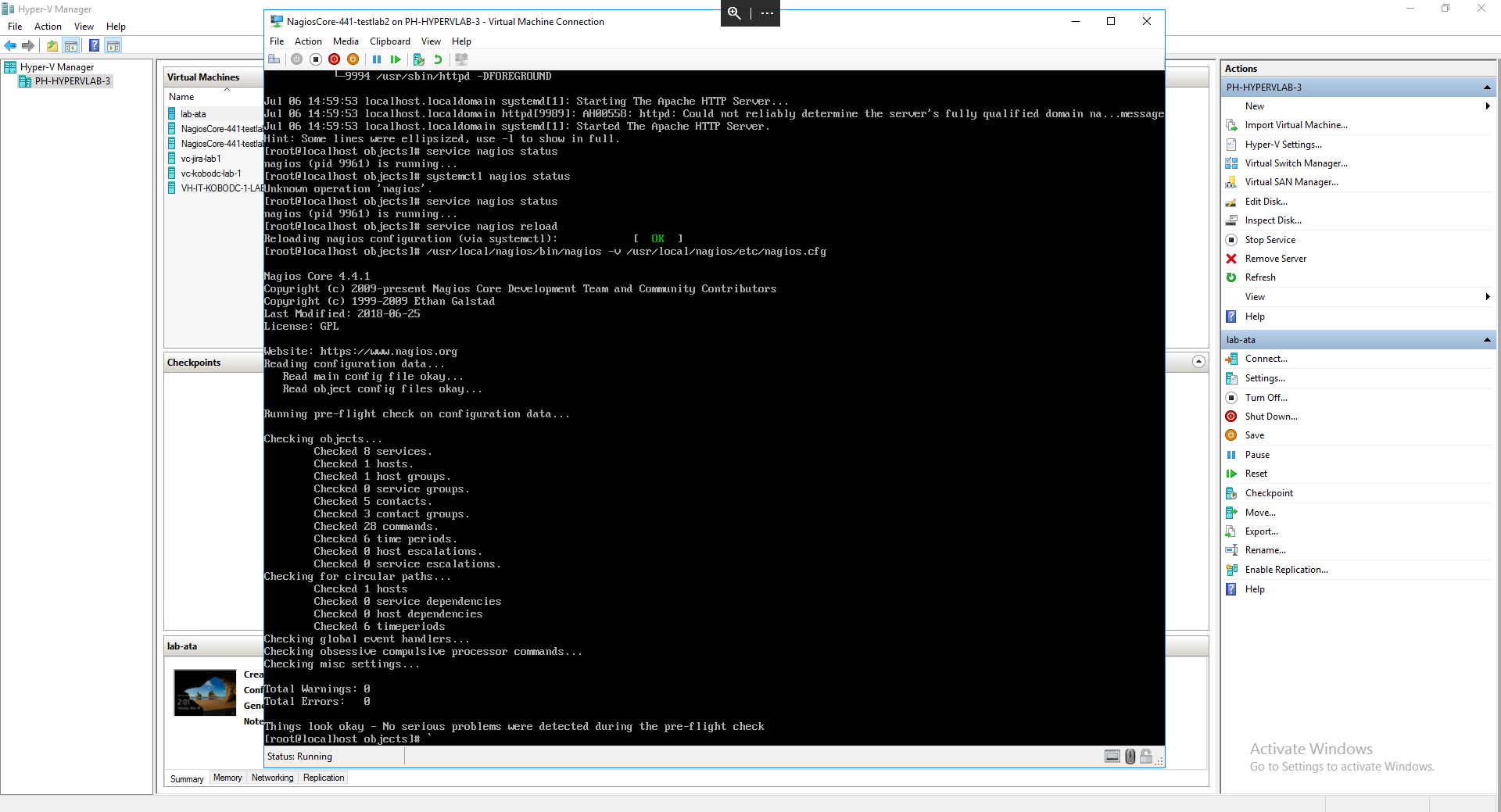

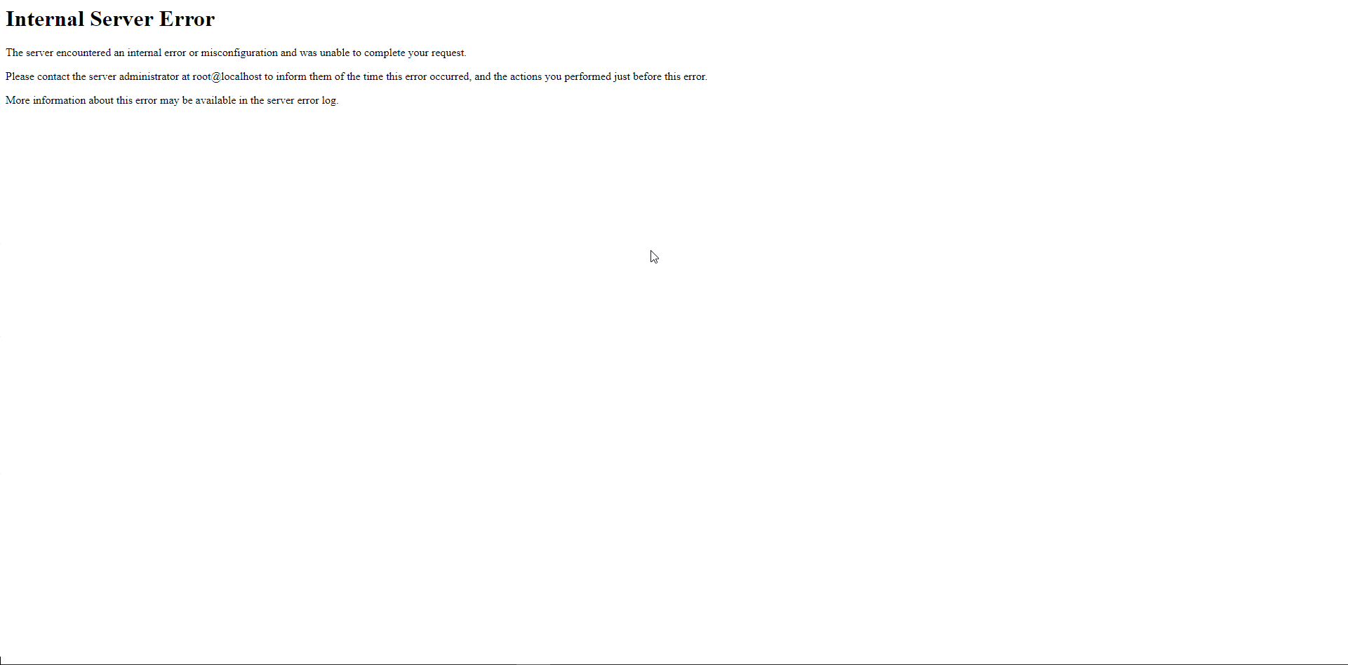

Postby mtripodi » Fri Jul 06, 2018 2:28 pm
I actually worked through all the errors today and ran the config test. All looks good now (see screenshot). I was even able to reload the nagios config and start the service. However, i'm no longer able to reach the web console after logging in. I confirmed the Apache HTTP server and service is running. Any ideas to help resolve? See second screenshot for error.
mtripodi
Posts: 49
Postby lmiltchev » Fri Jul 06, 2018 3:03 pm
1. Make sure selinux is disabled (not running).
sestatus
2. Clear cookies and the browser cache.
3. Verify the ip address by running in terminal:
ip addr
4. Try accessing the web UI by typing the following in the browser's address bar:
http://x.x.x.x/nagios
where you substitute the x.x.x.x with the actual IP address of your nagios server.
QA Manager
Posts: 10722
Postby mtripodi » Fri Jul 06, 2018 3:35 pm
Thanks, I have done all those steps, rebooted the server and continue to receive the same message after logging in. Any other ideas? I really need this working soon.
