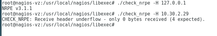

Hello everybody and sorry for my bad english language.
I just have configured a new Nagios server 4.3.4 on debian 9.
I need to use check_nrpe on this server to a Windows remote server 2012 R2 which is not on the same network. But for information "ping" is OK in both ways. I have setted up nsclient++ 0.5.1 such as all my others servers.
On my nagios server, I have installed NRPE 3.1.1 but I had the issue "could not complete ssl handshake" so I configure again with --disable-ssl and this problem is solved.
./configure --disable-ssl then "make" and "make all"
Please find my problem on the following attachment. NRPE is OK on localhost, but I have an error when i try the IP of my remote server.
For information, I have another nagios server (configured for french country) with NRPE 3.0.1. I have no problem with this command :
./check_nrpe -H 10.30.2.29
I (0.5.1.46 {...} seem to be doing fine
So I presume that there is no problem on the windows server (the client) but I miss something on my new nagios server ...
Could you help me please ?

Postby cocoyanouck » Fri Apr 20, 2018 8:16 am
Hum, your first link on github seems to be down.
This is what I did :
cd /tmp
wget http://downloads.sourceforge.net/project/nagios/nrpe-3.x/nrpe-3.1.1/nrpe-3.1.1.tar.gz
tar -zxvf nrpe-3.1.1.tar.gz
cd nrpe-3.1.1
./configure --enable-command-args --disable-ssl
make all
make install-config
make install-init
systemctl enable nrpe.service
cd /usr/local/nagios/libexec/
And on nrpe.cfg I have modified like this :
allowed_hosts=127.0.0.1,10.0.0.0/24,10.30.0.0/24
dont_blame_nrpe=1
Output OK :
root@nagios-vz:/usr/local/nagios/libexec# ./check_nrpe -H 127.0.0.1
NRPE v3.1.1
Output issue (but OK from another nagios server...) :
root@nagios-vz:/usr/local/nagios/libexec# ./check_nrpe -H 10.30.2.29
CHECK_NRPE: Receive header underflow - only 0 bytes received (4 expected).
PING 10.30.2.29 (10.30.2.29) 56(84) bytes of data.
64 bytes from 10.30.2.29: icmp_seq=1 ttl=125 time=178 ms

Postby cocoyanouck » Mon Apr 23, 2018 2:19 am
I launched the install script below :
cd /tmp
wget http://assets.nagios.com/downloads/nagi ... el4.tar.gz
tar xzf linux-nrpe-agent.tar.gz
cd linux-nrpe-agent
./fullinstall
I understand that now NRPE is running with xinetd service ?
So, when I run ./check_nrpe I have this :
NRPE v3.2.1
CHECK_NRPE: (ssl_err != 5) Error - Could not complete SSL handshake with 10.30.2.29: 1
Should I have to reinstall without the script and with the argument --disable-ssl ?

Starting Nmap 7.40 ( https://nmap.org ) at 2018-04-26 10:40 CEST
Nmap scan report for 10.30.2.38
Host is up (0.18s latency).
PORT STATE SERVICE
5666/tcp open nrpe
Nmap done: 1 IP address (1 host up) scanned in 0.45 seconds
root@nagios-vz:/usr/local/nagios/libexec# ./check_nrpe -H 10.30.2.38
CHECK_NRPE: (ssl_err != 5) Error - Could not complete SSL handshake with 10.30.2.38: 1
For information, I have tried to reinstall NRPE from source, and I have the same issue to the beginning. Please find all the code i have entered :

root@nagios-vz:/tmp/nrpe-3.2.1# ./configure --enable-command-args --disable-ssl

root@nagios-vz:/tmp/nrpe-3.2.1# service nrpe start
root@nagios-vz:/tmp/nrpe-3.2.1# cd /usr/local/nagios/libexec/

OK, here is what is happening, you are compiling the check_nrpe plugin without SSL enabled and the settings in the nsclient.ini file is looking for SSL connections.
In the NRPE agent and plugin, you have the capability to disable using SSL with a command line option.
If you add the -n option to the check, it will not use SSL.
So, recompile the NRPE agent and plugin and leave SSL enabled.
Then if you need to connect to a remote system without SSL, you would just add the -n option to the command.
Try that out and see if that fixes the issue.
