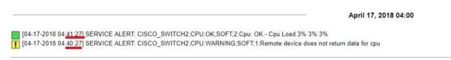

Dear All,
Could someone please help me to remove this warning alert? This warning alert in Alert History is appeared in very short time everyday.
i am using Nagios core to monitoring Cisco 3650X-24TS.
is anyone facing this issue and help me to solve this issue?
please see the caputer file.
Thank you all for your kind help.

It actually occurred, and will continue to do so unless you change the plugin. Removing it would be like re-writing history, and not really what should be done.
You can remove it form the nagios.log and it will remove from this page.

Thank you for your kind reply. Actually, what I meant it not only removing on page but also solve it out this aler. Is this possible to change only the plugin to solve this issue?
Thanks again.

myochit wrote:Is this possible to change only the plugin to solve this issue?
Possibly, I am not familiar with a plugin that return what this one did that gave the output "Remote device does not return data for cpu"
There is an infinite ways to configure Nagios so you will need to track down what plugin is running and perform some test from the command line, possibly changing to a more suitable plugin.
