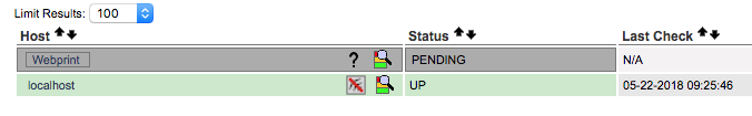

My main dashboard still shows my Webprint system greyed out and pending checks as seen in the attachment.

Re: Nagios Core - Passive checks no communication.
Have you sent a result as the host? Usually there are just services. Are the services coming in?
