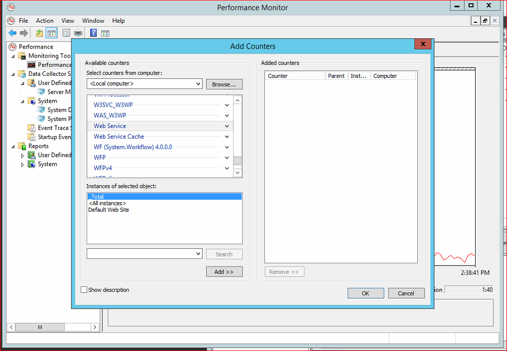

so you are sending "Default Web Site" as the name of one of the servers, is that what it is called?
If on the windows server you open perfmon add a counter and go to Web Service
What's in the list for choices? Is one of them "Default Web Site" ?

Postby kwhogster » Wed May 30, 2018 1:44 pm
Scott
Yes my IIS is setup with just Default Web Site
See attached
Perfmon
IIS
HTH
