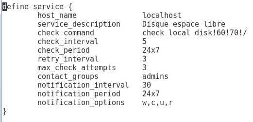

Here my config file of the service :
The nagios service was restart and I've checked my config with : /opt/nagios/bin/nagios -v /etc/nagios/nagios.cfg
All is fine
Thanks in advance

Your execution from the CLI contains a percentage, but your service definition only contains an integer. check_disk supports both percent and integer values and has different behaviors depending on what you pass it:
     -w, --warning=INTEGER
        Exit with WARNING status if less than INTEGER units of disk are free
     -w, --warning=PERCENT%
        Exit with WARNING status if less than PERCENT of disk space is free
     -c, --critical=INTEGER
        Exit with CRITICAL status if less than INTEGER units of disk are free
     -c, --critical=PERCENT%
        Exit with CRITICAL status if less than PERCENT of disk space is free
If you want to be alerted when the disk availability falls below a certain percentage, I would recommend including a percentage value passed to the warning/critical args in your service definition.

Yes !! It's this, thanks a lot mcapra :)
