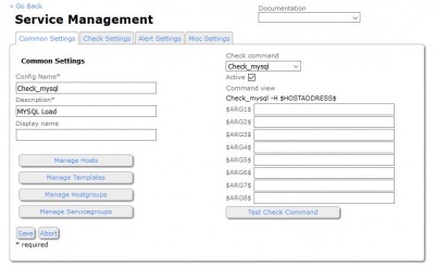

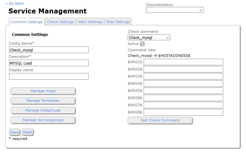

I'm using the student edition i brought, it has gui that i configure everything through. See the image for what it shows

Can you show us how the "Check_mysql" command is defined? You can probably see it under the CCM > Commands.

Check_mysql Check_mysql -H $HOSTADDRESS$

Hmm, usually the command would be defined as such:
check_mysql $USER1$/check_mysql -H $HOSTADDRESS$
where $USER1$ is the path to your plugins directory, for example "/usr/local/nagios/libexec".
Also, filenames in Linux are case-sensitive. Are you sure that your plugin is called "Check_mysql", not "check_mysql"?
