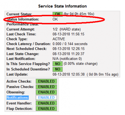

I am running check_mssql_health and part of the output is ommited or missing.
For example:
./check_mssql_health --server SQLSERVER --username 'domain\usernagios' --password '123456789' --mode=database-data-free --name=datanexus --commit
OK - database DataNexus has 23.74% free space left | 'db_datanexus_free_pct'=23.74%;10:;5:;0;100 'db_datanexus_free'=253505.69MB;106772.6625:;53386.3313:;0;1067726.625 'db_datanexus_allocated_pct'=81.68%;;;0;100
What I see to the nagios web interface is the OK output only and everything else is missing.
Any ideas why part of the output is missing?

Can you show the service configuration for the service in the screenshot as well as the configuration for the command the service uses?

This is strange.
The output is OK from command line but Nagios gets just an "OK" ??
