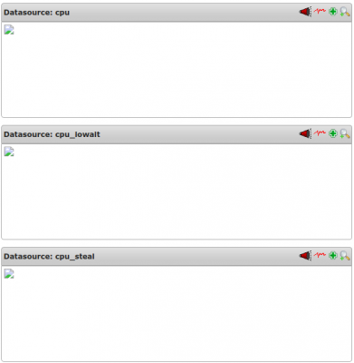

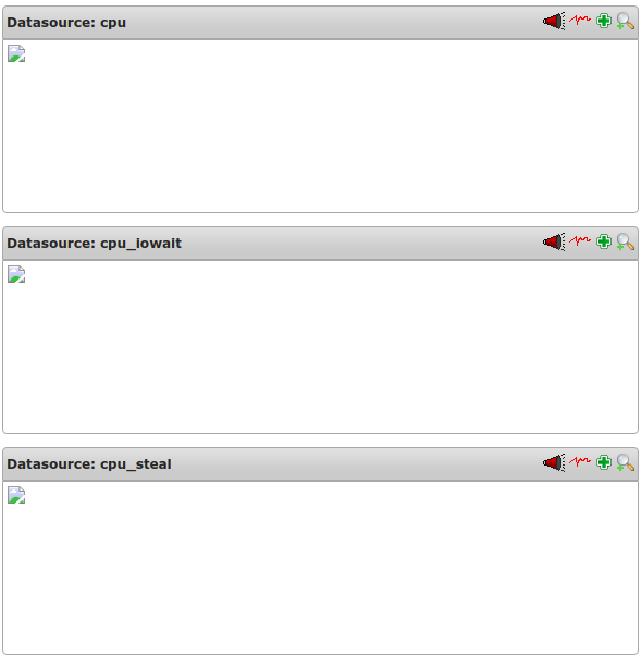

Hello All,
I getting an issue on nagios core PNP graphs can’t load for all hosts and services as you can see in attached screenshot.
I have removed pnp4nagios and reinstalled it but still getting same issue. On the other hand I have setup on other server with same configuration it’s working. Kindly let me know how can i troubleshoot it further ?

Hello, @rlinux57. Can you right click one of these graphs in a google chrome, click on Inspect, go to the Console tab and let me know what errors you're seeing(in red)?
Please upload the /etc/httpd/conf.d/pnp4nagios.conf file.
Please upload these log files:
/var/log/httpd/error_log
/var/log/httpd/ssl_error_log
Has pnp ever worked on this server?
