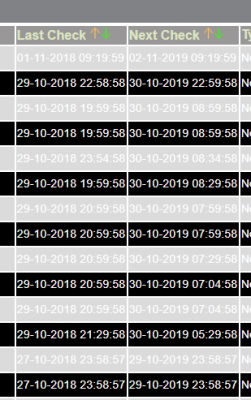

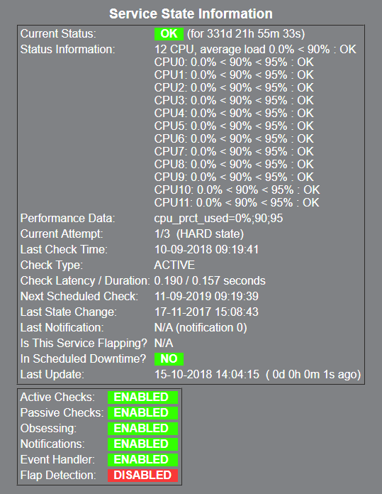

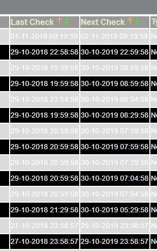

So I have an odd problem with Nagios core since a few months. For some reason the next check time of a service will be scheduled one year ahead after it is being executed. When I manually re-schedule the check it is working and the next scheduled time is correct again until some random point where it's getting wrong again. This happens for a lot of services with different which all have different check intervals. I don't see pattern in this behaviour.
As a workaround I have a script which sets the use_retained_scheduling_info to 0, restarts Nagios, sets it back to 1 and restarts again. This corrects the scheduled time for some checks but not for all.
Does anyone know what could be the reason of such behaviour?

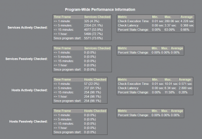

Which version of Nagios Core are you using?
How many total checks is Nagios Core processing? Can you share the output of a nagiostats execution?

I do not have the utility nagiostats. I can only share the output of the extinfo.cgi with you.
Is there any way to get the utility. I havent found any download source for it.
