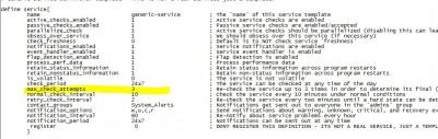

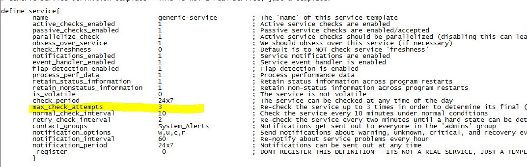

We also have a generic-service defined (see below) but it is not behaving as I would suspect.
I would assume Nagios would send an alert if it did not hear back from, or could not reach, NSClient++.

Can you elaborate on this ("but it is not behaving as I would suspect")? This is just a template. I am not sure if you are using it at all in your "version check" service... Unless you showed us your service config, along with all of the other relevant configs, commands, and templates, used by this service, we wouldn't know how to help you.We also have a generic-service defined (see below) but it is not behaving as I would suspect.
