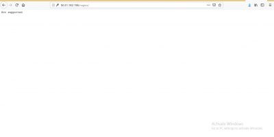

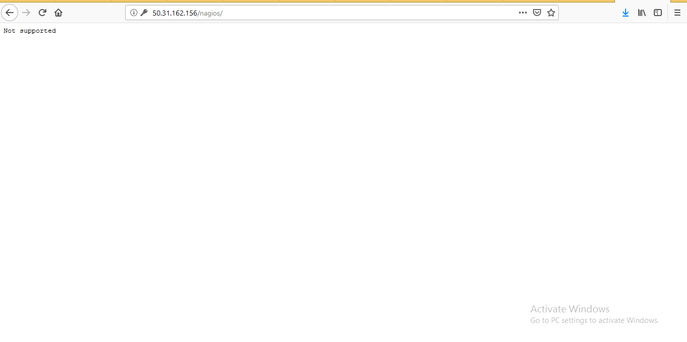

Postby vladjt7 » Tue Feb 12, 2019 11:37 am
Hereby I am enclosing the screen shot of the error message. I suspect its related CGI handler in the server.
