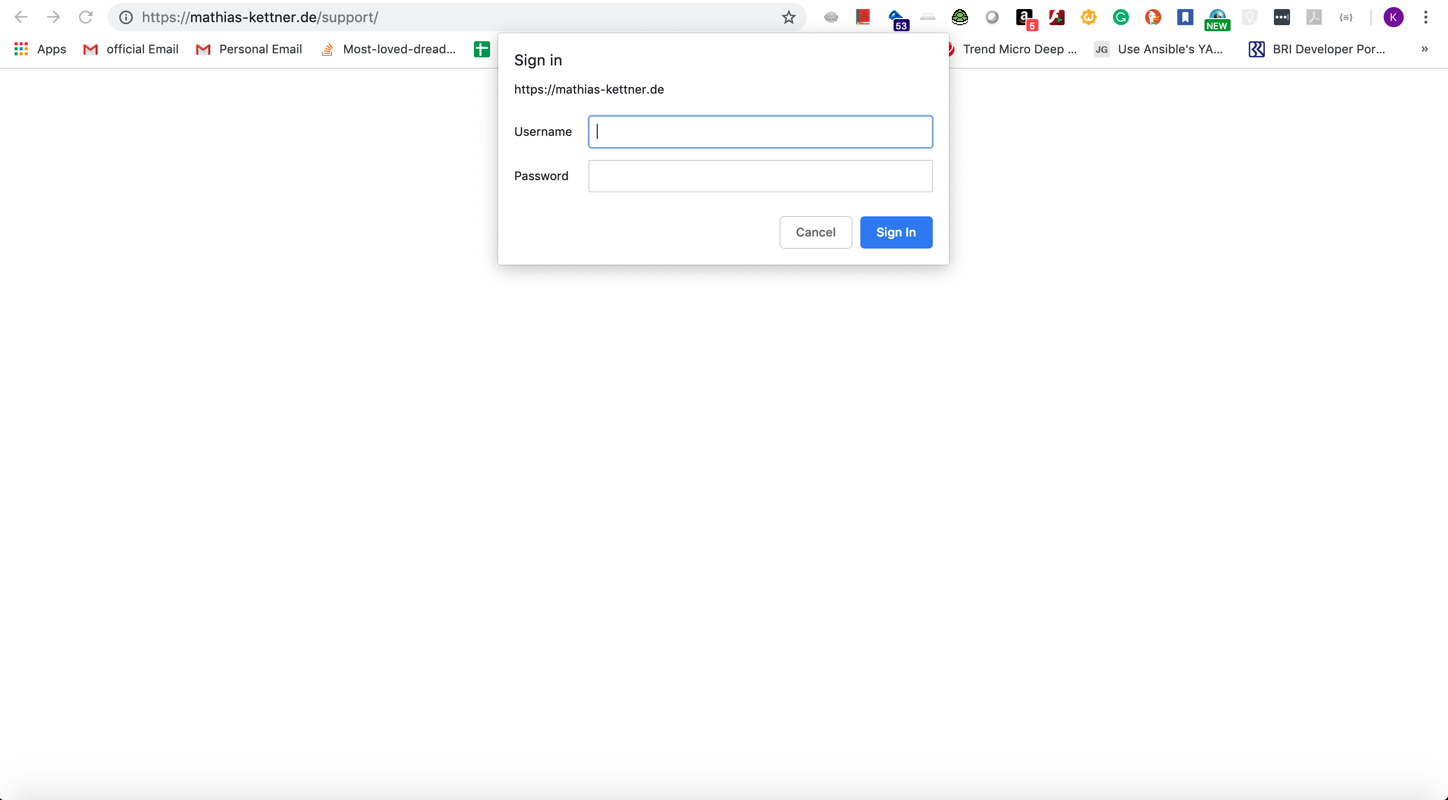

Also when i try to hit https://mathias-kettner.de/support/ it prompts me for username password and says
Authorization Required
This server could not verify that you are authorized to access the document requested. Either you supplied the wrong credentials (e.g., bad password), or your browser doesn't understand how to supply the credentials required.
Please comment.

kaushalshriyan
Posts: 120
Joined: Fri May 22, 2015 7:12 am
Re: check-mk-raw-1.5.0p12 on CentOS Linux release 7.6.1810
Post by kaushalshriyan »
Hi Nikita Polovenko,
I wanted to list the latest mk-livestatus software version using https://mathias-kettner.de/support/ and it prompted me to provide username and password. I have attached the screenshot for your reference.
For example the complete URL :- https://mathias-kettner.de/support/1.5.0p12/mk-livestatus-1.5.0p12.tar.gz
Please comment and i look forward to hearing from you.

npolovenko
Posts: 3457
Post by npolovenko »
@kaushalshriyan, Check_MK is a third party software and looks like this is the link to their support portal? We don't have any access to that.
From what I've read their community edition is free but the support is paid. More can be found here:
https://mathias-kettner.com/support.html
