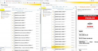

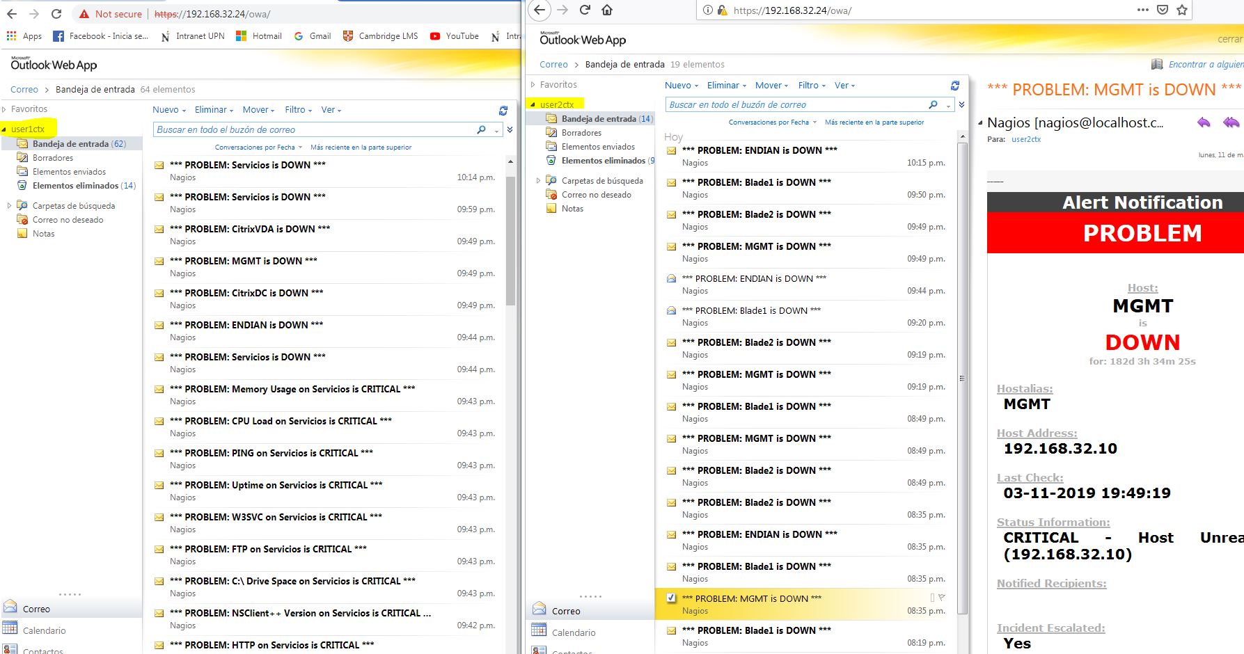

Please go to the Nagios Core web interface and then click on the link on the left hand side that says Notifications, send me an example of the output so that I can see if user3ctx is listed. Based on the config user3ctx should have received it.
Additionally, user3ctx looks to be using these notification commands"
Are those the proper ones?
service_notification_commands notify-service-by-email-html
host_notification_commands notify-host-by-email-html
Re: Query scaling nagios Core
Dear ssax,
Attached screenshots ..
Greetings.
Greetings.
- screenshots.docx
- (482.01 KiB) Downloaded 148 times
You Contact Notifications screenshot shows that user3ctx was notified:
That means that Nagios did what it was supposed to do and tried to fire off the notification.
