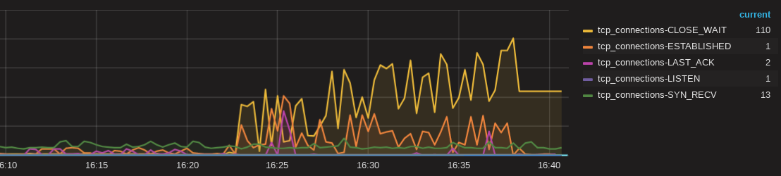

I would like to ask you to support with upgrade. Our installation default use NSCA (server & clients) v 2.7, but this version is missing on newer CentOS7. Here is only NSCA server v 2.9.
So, after upgrade to our monitoring server (CentOS6 -> CentOS7, NSCA 2.7 -> NSCA 2.9) everything works fine with NSCA clients v2.7.
But, when i want upgrade NSCA clients from v 2.7 to 2.9, many of connections on state CLOSE-WAIT rising on Nagios server machine (see screenshot). This upgrade i do only on one server! If i do it on few servers, rising much faster. It seems, that there is a bug, where many of connections are created, but only few closed.
In fact, i am facing with problem, when NSCA server and NSCA client is on same version and dont working as i expected.
Have you any idea with possible problem? Thank you for your effort.

This i spot in server syslog:
Yes, NSCA stop accepting notifications from clients and Nagios sent us huge amount of alert messages. After restart NSCA looks OK.
I spot this problem on testing environment, where default file descriptors was 1024. In production we have rised this value to 2048. It seems, that isnt enought. Rising again to 4096, hope that help.
Why NSCA server v2.9 open too many files?
Server IP is 45.33.80.18 and client IP is 178.79.165.168. Add requested files to my GoogleDrive.
Is there anything else, what can i do for you? Where do you assume the problem?
EDIT:
Mar 24 20:49:07 localhost nsca[13344]: Network server accept failure (24: Too many open files)
