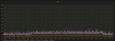

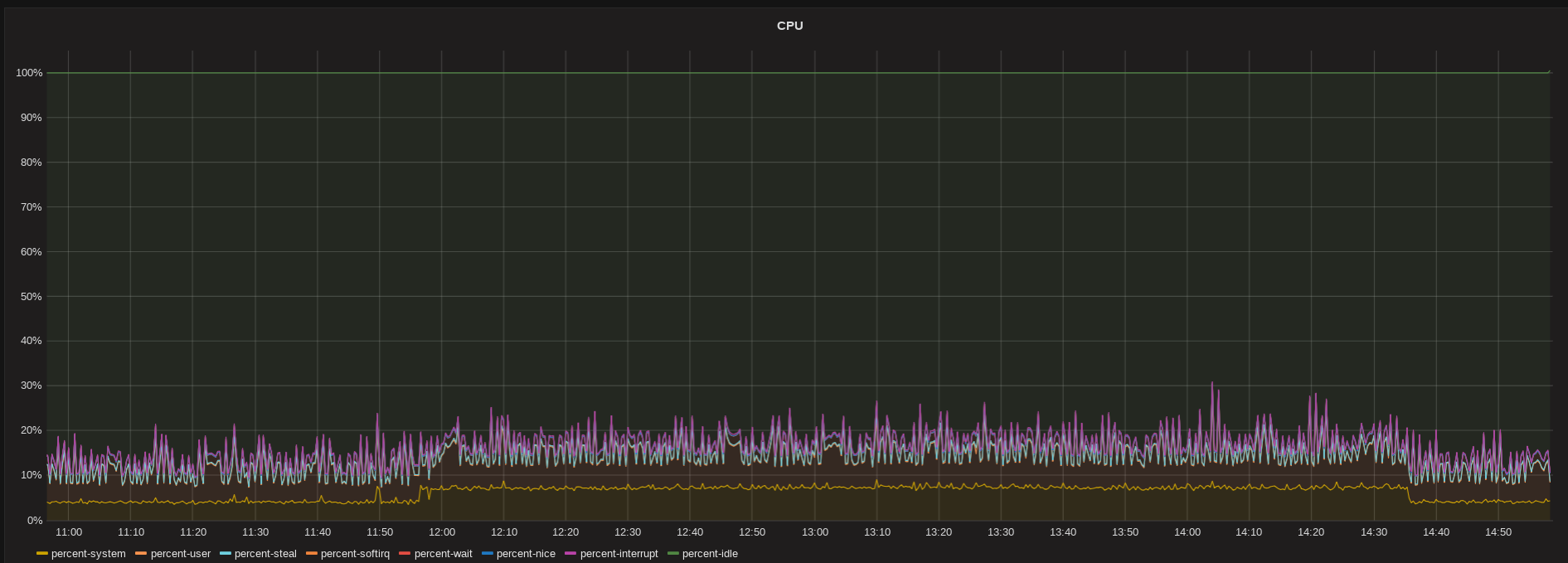

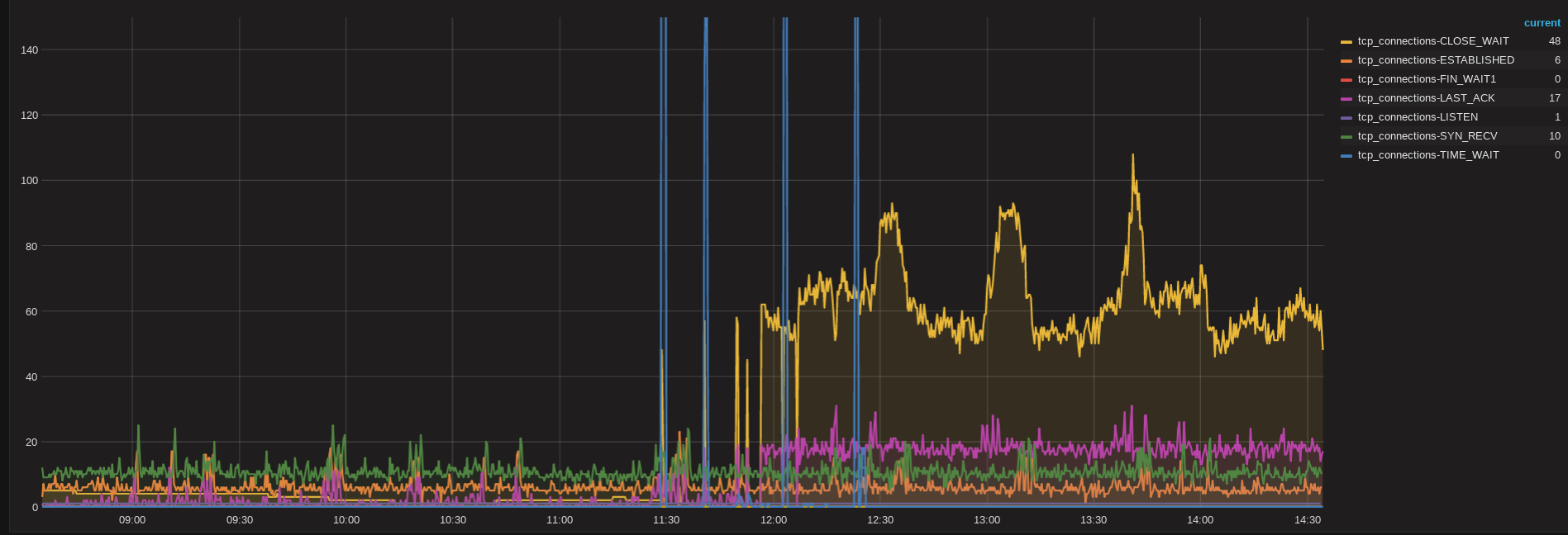

xinet CPU impact
xinet CPU impact
Default + testing state

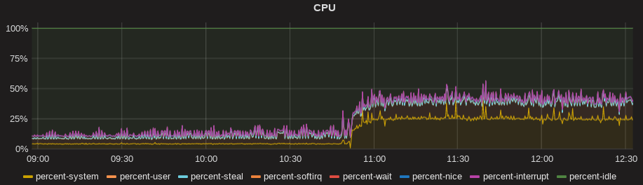

Hello.
Today i switch NSCA server from systemd to xinetd and another problems occured:
Mar 29 12:47:31 localhost xinetd[3812]: Exiting...
Mar 29 12:47:32 localhost systemd: Stopped Xinetd A Powerful Replacement For Inetd.
Mar 29 12:47:32 localhost systemd: Starting Xinetd A Powerful Replacement For Inetd...
Mar 29 12:47:32 localhost systemd: Started Xinetd A Powerful Replacement For Inetd.
Mar 29 12:47:32 localhost xinetd[578]: xinetd Version 2.3.15 started with libwrap loadavg labeled-networking options compiled in.
Mar 29 12:47:32 localhost xinetd[578]: Started working: 8 available services
Mar 29 12:47:36 localhost kernel: TCP: request_sock_TCP: Possible SYN flooding on port 5666. Sending cookies.  Check SNMP counters.
Mar 29 12:47:41 localhost kernel: TCP: request_sock_TCP: Possible SYN flooding on port 5660. Sending cookies.  Check SNMP counters.
Mar 29 12:48:13 localhost kernel: TCP: request_sock_TCP: Possible SYN flooding on port 5664. Sending cookies.  Check SNMP counters.
Mar 29 12:48:13 localhost kernel: TCP: request_sock_TCP: Possible SYN flooding on port 5663. Sending cookies.  Check SNMP counters.
Mar 29 12:48:13 localhost kernel: TCP: request_sock_TCP: Possible SYN flooding on port 5662. Sending cookies.  Check SNMP counters.
Mar 29 12:49:33 localhost nagios: job 19576 (pid=7206): read() returned error 11
We have large cloud installation across all world and on each NSCA port (thread) we have different geo-cluster. Each geo-cluster have aproximetlly 50-100 servers (KVM containers, not bare metal machines).
This problem with SYN flooding we spot, when we have more like 200 servers per one NSCA TCP port on SysV modification too (CentOS6, NSCA server 2.7). This was main reason, why we must split our monitoring to geo-clusters. It seems, that xinetd modification have this limit much lower (~25 servers per one TCP port) with higher CPU load.
CPU load rise too, but by my opinion, to unacceptable scope (+ ~50%!).
I must revert this solution back :( .
I would like to ask you to any idea to check, that is working. My goal is have monitoring server on CentOS7 (actaully is), with NSCA server v2.9 (actaully is too) and NSCA clients v2.9 (actaully here is a problem with sending notifications).
Thank you very much for your effort.

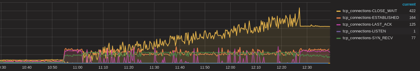

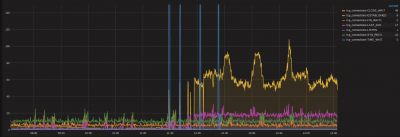

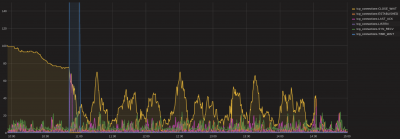

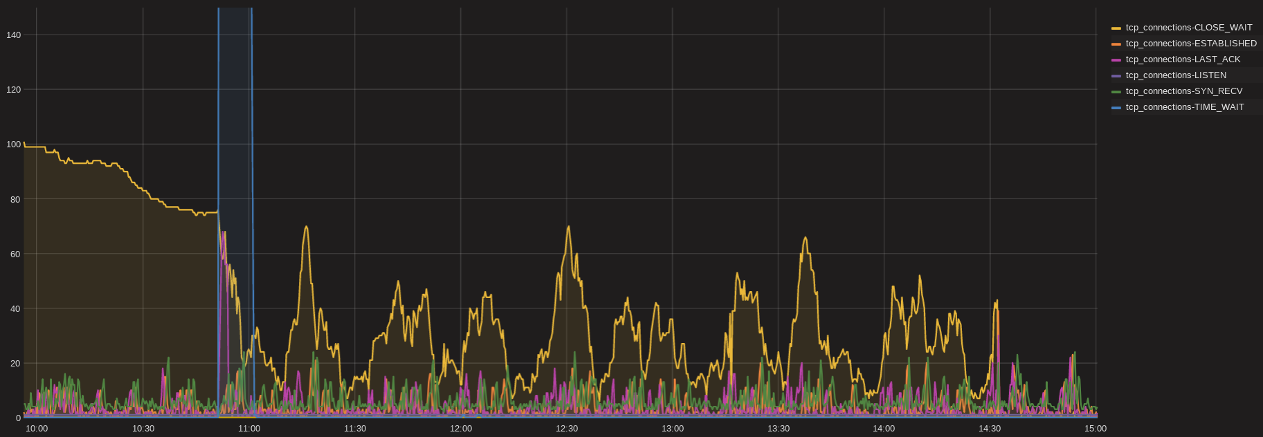

Hello.
Is this on an XI machine or just a Core machine? What versions? I'd like to do some more testing and want to make sure the systems are as similar as possible.
Nagios is default version included in epel repository on CentOS7 (Version: 4.4.3, Revision: 1.el7, Repository: epel) and NSCA too (Version: 2.9.2, Revision: 1.el7, Repository: epel).
If you're able to go back to xinetd - I'd try to increase the socket backlog and currently-handshaking limits following ...
Yes, i try it too, but after several hours, any change not have effect.
net.core.somaxconn = 120000
net.ipv4.tcp_max_syn_backlog = 6000000
net.netfilter.nf_conntrack_tcp_timeout_time_wait = 60
net.core.rmem_max=24000000
net.core.wmem_max=212992
net.ipv4.tcp_synack_retries=2
net.ipv4.tcp_slow_start_after_idle=0
net.netfilter.nf_conntrack_max=2000000
net.core.netdev_max_backlog=128000
... and this values is near double, like we using on application loadbalancers with thousand requests per seconds. I think, crazy values :).
In xinetd config i must use this values:
per_source      = 400
instances       = 800
cps             = 550 10
... for success running.
You can see network status on screenshot (testing ~11:00 -> ~14:30, most load geocluster). Still ~100 connections in TIME_WAIT state, but i think, this maybe was default behaviour for xinetd.
This server instance have allocated 4cores (Xeon CPU on bare metal) and 8GB RAM. No other software here running, provide only supervising services via Nagios.
Every server sent ~5-10 checks per 10 seconds.
If you need some aditional information, please, let me know. As i wrote, i need solve this problem. If you have some theory for testing, glad to try it. For manage this large infrastructure we using SaltStack, so, i wrote states for deploying. Can be easly and quickly switching between configurations, but cost some time for developing.
Many thanks for your effort.

tcp        1      0 45.33.80.18:5662        212.111.43.83:42794     CLOSE_WAIT  4879/nsca_uk
tcp        1      0 45.33.80.18:5662        212.111.43.83:48628     CLOSE_WAIT  4879/nsca_uk
tcp        1      0 45.33.80.18:5662        212.111.43.83:51626     CLOSE_WAIT  4879/nsca_uk
tcp        1      0 45.33.80.18:5662        212.111.43.83:41789     CLOSE_WAIT  4879/nsca_uk
tcp        1      0 45.33.80.18:5662        212.111.43.83:40794     CLOSE_WAIT  4879/nsca_uk
tcp        1      0 45.33.80.18:5662        212.111.43.83:44250     CLOSE_WAIT  4879/nsca_uk
tcp        1      0 45.33.80.18:5662        212.111.43.83:46255     CLOSE_WAIT  4879/nsca_uk
tcp        1      0 45.33.80.18:5662        212.111.43.83:49628     CLOSE_WAIT  4879/nsca_uk
tcp        1      0 45.33.80.18:5662        212.111.43.83:52325     CLOSE_WAIT  4879/nsca_uk
tcp        1      0 45.33.80.18:5662        212.111.43.83:40884     CLOSE_WAIT  4879/nsca_uk
tcp        1      0 45.33.80.18:5662        212.111.43.83:47640     CLOSE_WAIT  4879/nsca_uk
tcp        1      0 45.33.80.18:5662        212.111.43.83:37520     CLOSE_WAIT  4879/nsca_uk
I think, but not sure, that NSCA client v2.9 attempt to establish stream, not a single connect. Attempt to recycle existed connections, but still create new one. Bug?
If you wish, i can run this test on NSCA server v2.9 via xinetd, but this solution overload server, i dont want use this solution.
Thank you for your effort.

The strace did show a lot of messages regarding not being able to allocate enough memory and the syslog showed a lot of messages regarding having a lot of files open so I think this has to do with system settings. What is the output of "ulimit -a"? Do you have anything configured in /etc/sysctl.conf or /etc/security/limits.conf? Check out https://support.nagios.com/kb/article/n ... ng-19.html for an example of increasing values via /etc/security/limits.conf.
lhozzan
Posts: 21
Joined: Wed Mar 20, 2019 10:43 am
Re: NSCA 2.9 client problem
Post by lhozzan »
Hello.
Yes, we have custom unit file for systemd:
[Unit]
#Description=Nagios Service Check Acceptor
Description=NSCA for uk cluster
After=syslog.target network.target auditd.service
[Service]
# default LimitNOFILE 1024 is too low
LimitNOFILE=4096
EnvironmentFile=-/etc/sysconfig/nsca
ExecStart=/usr/sbin/nsca_uk $OPTIONS -c /etc/nagios/nsca_uk.cfg
ExecReload=/bin/kill -HUP $MAINPID
Type=forking
# Auto-restart, when fail
Restart=on-failure
RestartSec=10
StartLimitInterval=35
StartLimitBurst=3
[Install]
WantedBy=multi-user.target
When open files limit is reached, NSCA generate error about problem with opened new file and stop accepting new checks. If you wish, i can rise this value, but not sure, that help.
[operator@server ~]$ ulimit -a
core file size          (blocks, -c) 0
data seg size           (kbytes, -d) unlimited
scheduling priority             (-e) 0
file size               (blocks, -f) unlimited
pending signals                 (-i) 31824
max locked memory       (kbytes, -l) 64
max memory size         (kbytes, -m) unlimited
open files                      (-n) 1024
pipe size            (512 bytes, -p) 8
POSIX message queues     (bytes, -q) 819200
real-time priority              (-r) 0
stack size              (kbytes, -s) 8192
cpu time               (seconds, -t) unlimited
max user processes              (-u) 31824
virtual memory          (kbytes, -v) unlimited
file locks                      (-x) unlimited
No, we using default values. In this configs is only coments.
OK, attempt place this values and let you know.
lhozzan
Posts: 21
Post by lhozzan »
Hello.
Unfortunatelly, this isnt working too. Equal behavior.
Have you aditional idea, what to check?
