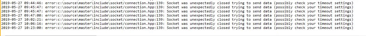

Postby gouravin » Mon May 27, 2019 5:46 am
Hi Experts,
I am using below PS script to check connection. This is checking connection on given IP from Nagios Monitor client on defined port.
$returnStateOK = 1
$returnStateCritical = 0
$Ipaddress= '10.130.259.601'
$Port= '8080'
$t = New-Object Net.Sockets.TcpClient
$t.Connect($Ipaddress,$Port)
if($t.Connected)
"Port $Port is operational"
$returnStateOK
}else
"Port $Port is closed "
This script is generally working fine however when i am trying to use this through Nagios. I have below errors: -\
Error
Nagios Error
Please help me what i missed here, Thanks in advance :)
gouravin
Posts: 8
Joined: Thu Feb 14, 2019 1:03 am
Re: Is connection monitoring possible from Nagios Core
Postby dwhitfield » Mon May 27, 2019 1:23 pm
What version of NSClient are you using? If memory serves, NSC.ini is the 3.x-type ini file, and NSClient 3.x is probably not what you want.
That said, the error looks like you have a networking issue. Firewall, perhaps?
Need additional support for CentOS or ubuntu? Try OpenLogic: https://www.openlogic.com/talk-to-expert
We can write Nagios plugins for you!
We are hiring: https://www.perforce.com/careers
Posts: 4577
Postby scottwilkerson » Tue May 28, 2019 12:12 pm
dwhitfield wrote:What version of NSClient are you using? If memory serves, NSC.ini is the 3.x-type ini file, and NSClient 3.x is probably not what you want.
I agree there could be a firewall issue, also your script doesn't seem to be using the exit keyword as it should, may I suggest the following edits
$returnStateOK = 1
$Port= '8080'
if($t.Connected)
Write-Host "Port $Port is operational"
exit $returnStateOK
}else
Write-Host "Port $Port is closed "
exit $returnStateCritical
