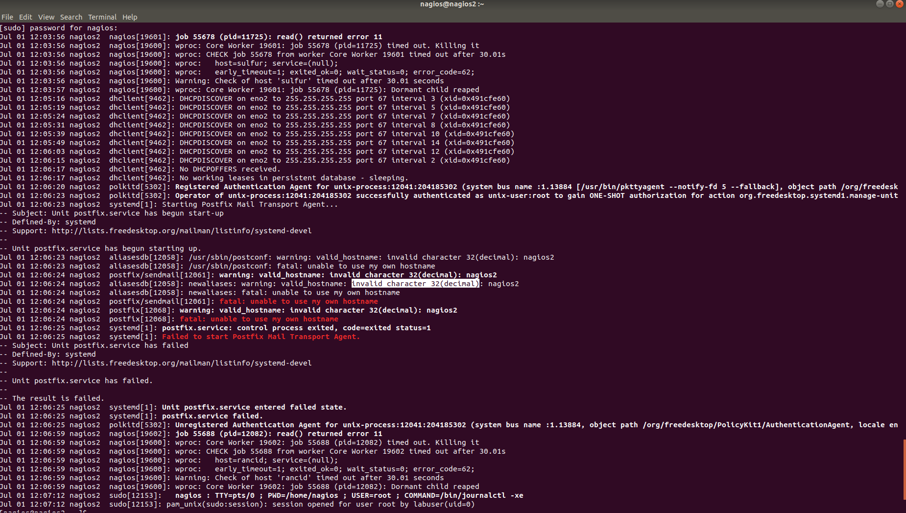

Also, It throws some error message when I tried to execute command below.
# systemctl restart postfix.service
Job for postfix.service failed because the control process exited with error code. See "systemctl status postfix.service" and "journalctl -xe" for details.
[nagios@nagios2 ~]$ sudo journalctl -xe

Jul 01 12:06:23 nagios2 aliasesdb[12058]: /usr/sbin/postconf: warning: valid_hostname: invalid character 32(decimal): nagios2
Jul 01 12:06:23 nagios2 aliasesdb[12058]: /usr/sbin/postconf: fatal: unable to use my own hostname
Jul 01 12:06:24 nagios2 postfix/sendmail[12061]: warning: valid_hostname: invalid character 32(decimal): nagios2
Jul 01 12:06:24 nagios2 aliasesdb[12058]: newaliases: warning: valid_hostname: invalid character 32(decimal): nagios2
Jul 01 12:06:24 nagios2 aliasesdb[12058]: newaliases: fatal: unable to use my own hostname
Jul 01 12:06:24 nagios2 postfix/sendmail[12061]: fatal: unable to use my own hostname
Jul 01 12:06:24 nagios2 postfix[12068]: warning: valid_hostname: invalid character 32(decimal): nagios2
Jul 01 12:06:24 nagios2 postfix[12068]: fatal: unable to use my own hostname
Jul 01 12:06:25 nagios2 systemd[1]: postfix.service: control process exited, code=exited status=1
Jul 01 12:06:25 nagios2 systemd[1]: Failed to start Postfix Mail Transport Agent.

cdienger
Posts: 5045
Re: set up email alerts notification in RHEL7
Post by cdienger »
Decimal 32 is a space. It would appear the configuration has an extra space in the hostname somewhere. Check in main.cf.
