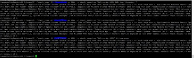

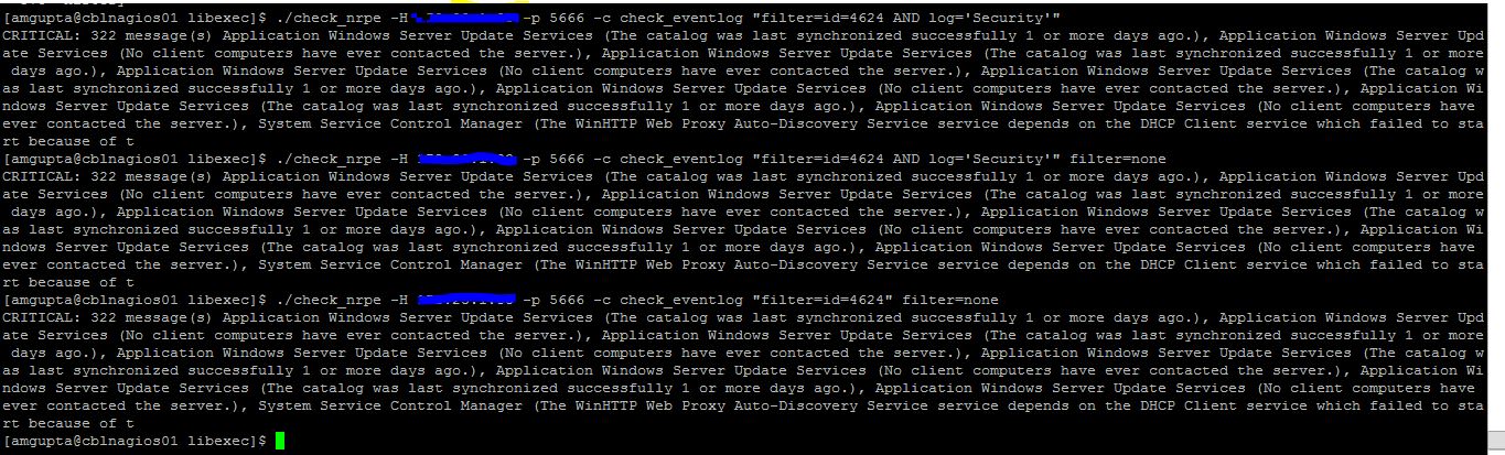

Postby amitgupta19 » Thu Oct 03, 2019 12:16 pm
please refer to the screenshot attached.
It is still not searching in the Security Log.
The message that it is giving is for the id=7001 in Systems Event Log.
