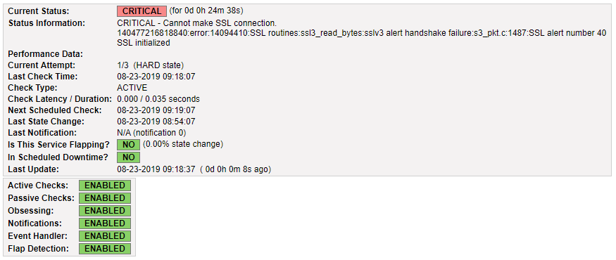

we receive with the check_http command this error
SSL routines:ssl3_read_bytes:sslv3 alert handshake failure:s3_pkt.c:1487:SSL alert number 40
only in nagios webinterface!
But from cmd line it's works without errors. This is a odd behavior.

The result of the web interface is attached as a screenshot. We can't explain this behavior.
Nagios Service with error

That error is indicative of the hostname not being properly sent to download the right certificate, if I recall correctly.
Can you increase the verbosity of the check definition? -vvv And then provide the output?
