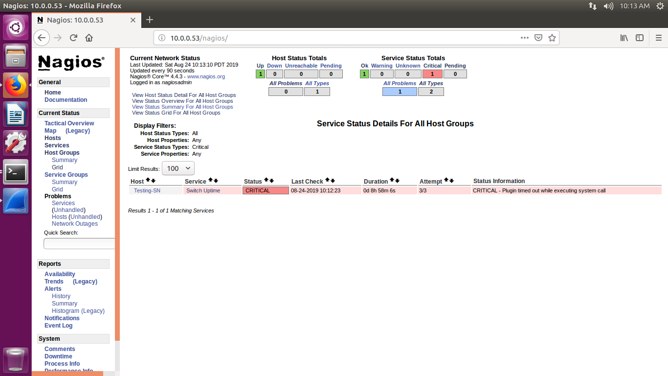

I have installed Nagios Core on an Ubuntu VMWare machine for monitoring my network appliances. But I am constantly facing trouble running SNMP on Nagios Core. I have added a single Cisco switch under hosts, but I see this error ' CRITICAL - Plugin timed out while executing system call.' The screenshot for the same is attached herewith.

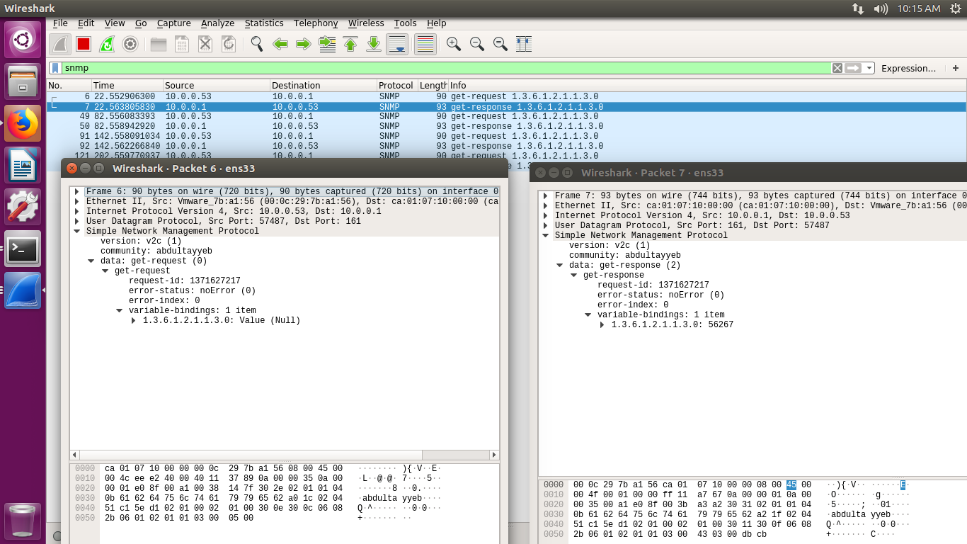

In fact, I was able to see SNMP GET requests made by my Ubuntu server and the corresponding SNMP GET RESPONSE in Wireshark when the Nagios Core was running. But still, the service status for that host remained ' CRITICAL - Plugin timed out while executing system call '. Attached is the image of my Wireshark capture, while Nagios Core was running.

Nagios has some internal timeouts that apply to all plugin executions. SNMP is sloooowwwww. If your snmpget command takes longer than 60 seconds to return, you may be hitting the service_check_timeout limit, which triggers Nagios to kill the check.
You could start with adjusting the -t argument passed to your check_snmp command definition. Not sure what that command definition looks like on your system, but you may also be able to pass -t 60 directly in your service definition.

Additionally, to compare apples to apples you should run the exact same query from the CLI like this:
su - nagios
time /usr/local/nagios/libexec/yourplugin.ext --with-all-arguments -t 90
That will give you the average time it takes to run it (by prepending the command with time).
