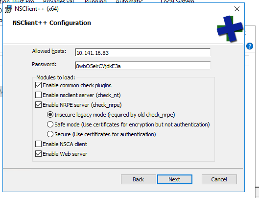

I downloaded the NSClient++ Agent on Windows Machine and the download says NSCP-0.5.2.35-x64.msi
I installed the client with the windows installer.
/usr/local/nagios/bin/nagios -v /usr/local/nagios/etc/nagios.cfg shows Things look okay - No serious problems were detected during the pre-flight check
however, I'm getting Critical Error Socket Timeouts
I'm not sure if I have the windows configuration correct. also, I do not understand if NRPE is needed, when I use it, it complains, It doesn't look like the windows services use NRPE ????

NSClient can be used either with check_nt or check_nrpe. It looks like check_nrpe is communicating. What happens when you run the following commands (replace IP address and password) from the shell in /usr/local/nagios/libexec/. Which ones return valid results?
Have you considered using NCPA (Nagios Cross Platform Agent) for Windows? In my opinion, it's easier to get up and running with NCPA.
NCPA Agent Instructions
/check_nt -H 10.25.14.10 -p 12489 -s 'Str0ngP@ssw0rd' -v MEMUSE -w 90 -c 95
./check_nrpe -H 10.25.14.10 -c check_memory -a 'warn=used>90%' 'crit=used>95%'
Re: configuring a windows server for monitoring
thank you Benjamin!!!
[root@alpcts000001083 libexec]# ./check_nrpe -H 10.141.16.83 -c check_memory -a 'warn=used>90%' 'crit=used>95%'
CHECK_NRPE: Error - Could not connect to 10.141.16.83. Check system logs on 10.141.16.83
[root@alpcts000001083 libexec]# ./check_nt -H 10.141.16.83 -p 12489 -s 'uyY85vCt' -v MEMUSE -w 90 -c 95
CRITICAL - Socket timeout

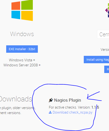

Benjamin, I've included an attachment, I've tried installing check_nt, check_nrpe, both, ... IDK?
I think I will try the NCPA (Nagios Cross Platform Agent) - give this a try.
Benjamin,
can you please take a look at the attachment? is that what I should download?

On the remote host you'll download and install the NCPA agent for Windows. There's only the EXE 32bit installer available right now.
Now, on the Nagios side you'll need to install the check_ncpa.py plugin. Make sure you set the correct permissions so the Nagios user can run the plugin.
https://www.nagios.org/ncpa/getting-started.php
thanks, I was confused, windows is 64 bit, windows enterprise 16. I'm giving this a try.

thanks! you were right! it is working now, easily with Nagios Cross Platform Agent, NCPA, excellent!
