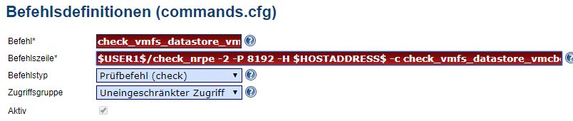

Then this in my NagiosQL (see attachment).

Posts: 9177
Re: check_nrpe invalid packet type received from server
What version of the check_nrpe plugin are you using?
Depending on the version, they could not accept a large size payload as you specified.
Try setting the payload to 1024 and see if that works.
