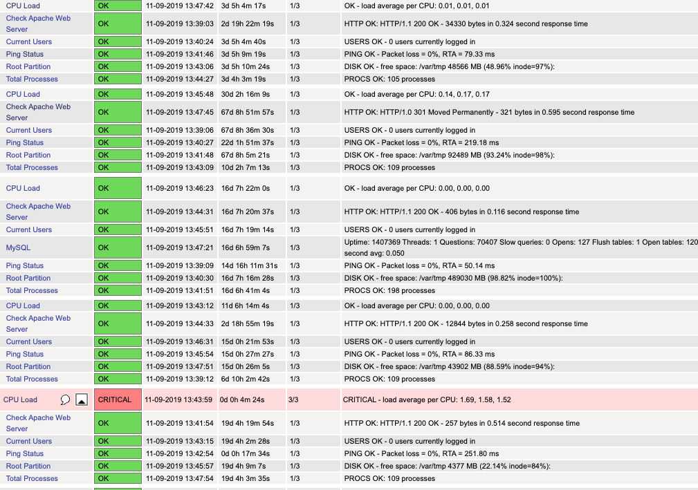

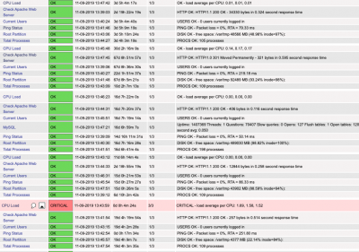

As you can in the attachment my Nagios server monitoring a lot of client machines and each client machines having different types of services, I just want to create a notification here as we seen here like services here already like apache, users and disks so if the services stopped I will get a mail notification as well... now some services are stopping in the client machines without any notification and I came to know about the issue only after informed by the client and Can you suggest me a solution to get rid of this issue which I'm facing now
Thank you in advance for your kind support
monitoringclieentsandservices

Postby mbellerue » Mon Nov 11, 2019 12:18 pm
Either of the options mentioned above will be able to monitor a custom service. For simplicity, it may be easiest to use NCPA. NCPA will handle listing out the services, and all you have to do is tell Nagios which service you want to make sure is running.

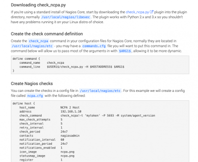

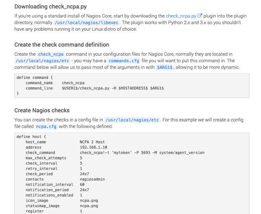

Where do i perform the task as i mentioned in attachment
wheredoi perform this task

Postby mbellerue » Wed Nov 20, 2019 1:15 pm
Yes, NCPA is only installed on the client machine.
The tasks in that attachment have you working with your Nagios configuration files. By default they are in /usr/local/nagios/etc/ and /usr/local/nagios/etc/objects/
