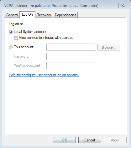

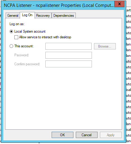

Hmm, my permissions are exactly the same. I don't understand why NCPA would not be able to run the script if it is running as a "Local System Account"... unless you changed the user NCPA is running under.

I have not changed it, should have all default settings.

Just curious, does it work if you change user that NCPA runs under from "Local System account" to "Administrator"?
