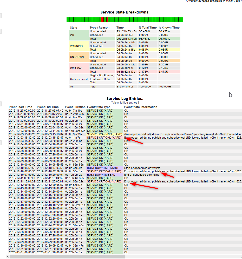

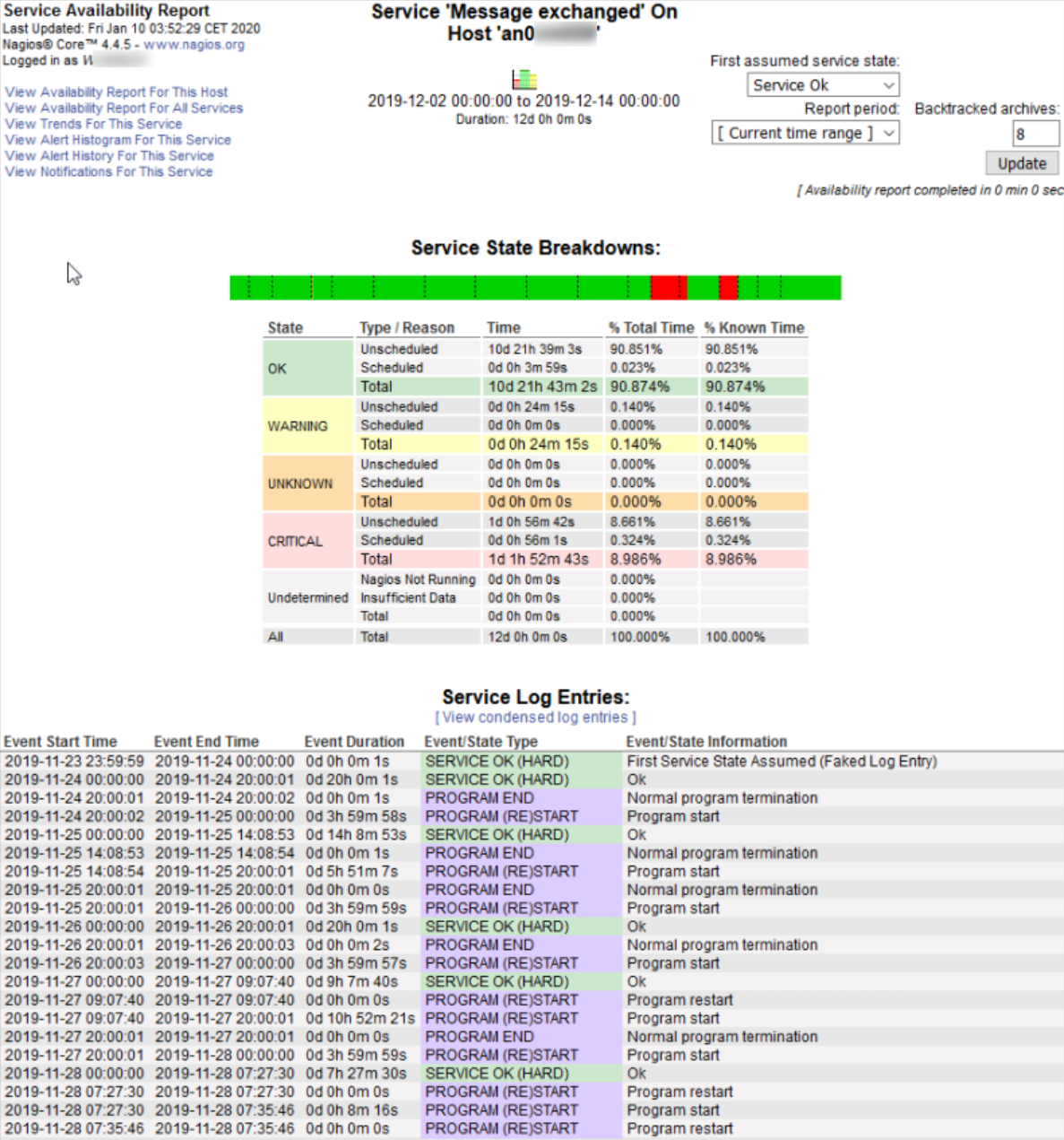

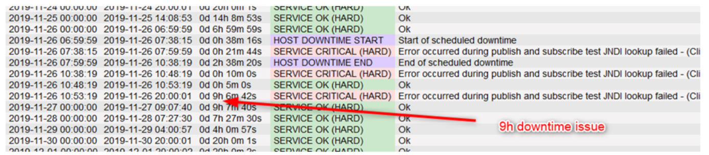

I use nagios core to generate availability report for one service , in the availability report chart , i see this service's critical time is totally 1d 1h 52m 43s (this duration seems much bigger than what we observed in reallife in last month ), but from the detailed Service Log Entries, i really can't find how this time is calculated , can you help to point out?

In the whole Dec ,only 3 occurance of the critical alert, and 1 occurance is in the maintenance window, so i think it haven't be calculated in.

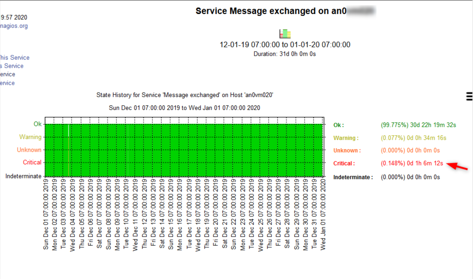

When i click in the "Service State Breakdowns" diagram, i see following detail ,and in this diagram , the critical time is only: Critical : (0.148%) 0d 1h 6m 12s for the whole last month , why here it is much smaller?

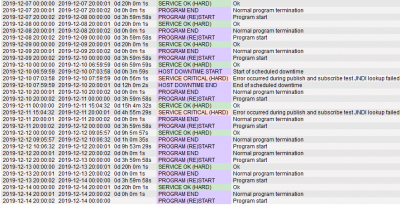

Re: Service Availability Report seems not accurate for my se
From 12/10 - 12/11 when the service went down during downtime the recovery didn't come until 15h 4m 32s after the downtime ended.source888 wrote:In the whole Dec ,only 3 occurance of the critical alert, and 1 occurance is in the maintenance window, so i think it haven't be calculated in.
This time counts and is added to the other times.

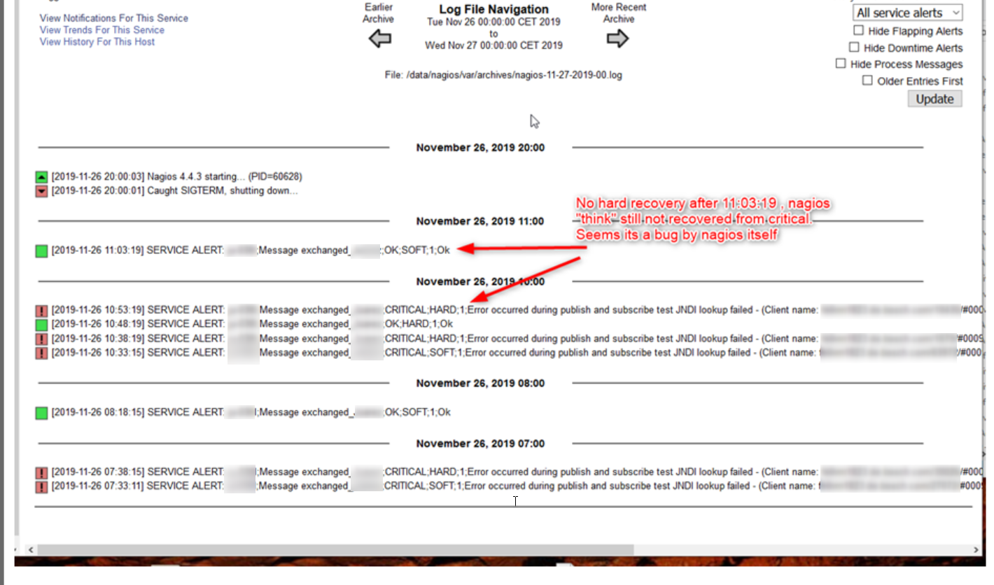

What cause the report not correct as i think now seem a issue in "soft recovery " not going to "hard recovery" ,as you can see in the following screenshot , there exist one soft recovery on 2019-11-26 11:03:19 ,but then until 2019-11-27 00:00:00 ,this period are all calculated as service critial , and at this time , i assume when see in the service view , this service is green as it is in soft recovery state.
The downtime had already ended before that 9hour downtime so that time counts
For that 9 hour critical period , the info i can get from availability report and service event log is following:
on 2019-11-26 10:53:19 , there starts a new service critical (HARD)
on 2019-11-26 11:03:19 , there occurs a OK (SOFT)
on 2019-11-26 20:00:01 , nagios process restart
on 2019-11-27 00:00:00 , on availability report , finally see that service become OK (HARD)
so currently my confusion is why this service can't get an OK (HARD) after the first OK (SOFT) on 2019-11-26 11:03:19 . Is it possible there still exist the bug which was mentioned get fixed in 4.4.3 version , that is : * Fixed services in soft states sometimes not switching into hard states (#576) (Jake Omann)
If it was in a SOFT CRITICAL the recovery that is logged should be SOFT. It will switch to a hard (in memory) but the recorded as SOFT so event handlers trigger appropriately.
Here's the docs on state types with examples
https://assets.nagios.com/downloads/nag ... types.html
Re:
Re:
Service experiences a SOFT recovery. Event handlers execute, but notification are not sent, as this wasn't a "real" problem. State type is set HARD and check # is reset to 1 immediately after this happens.
