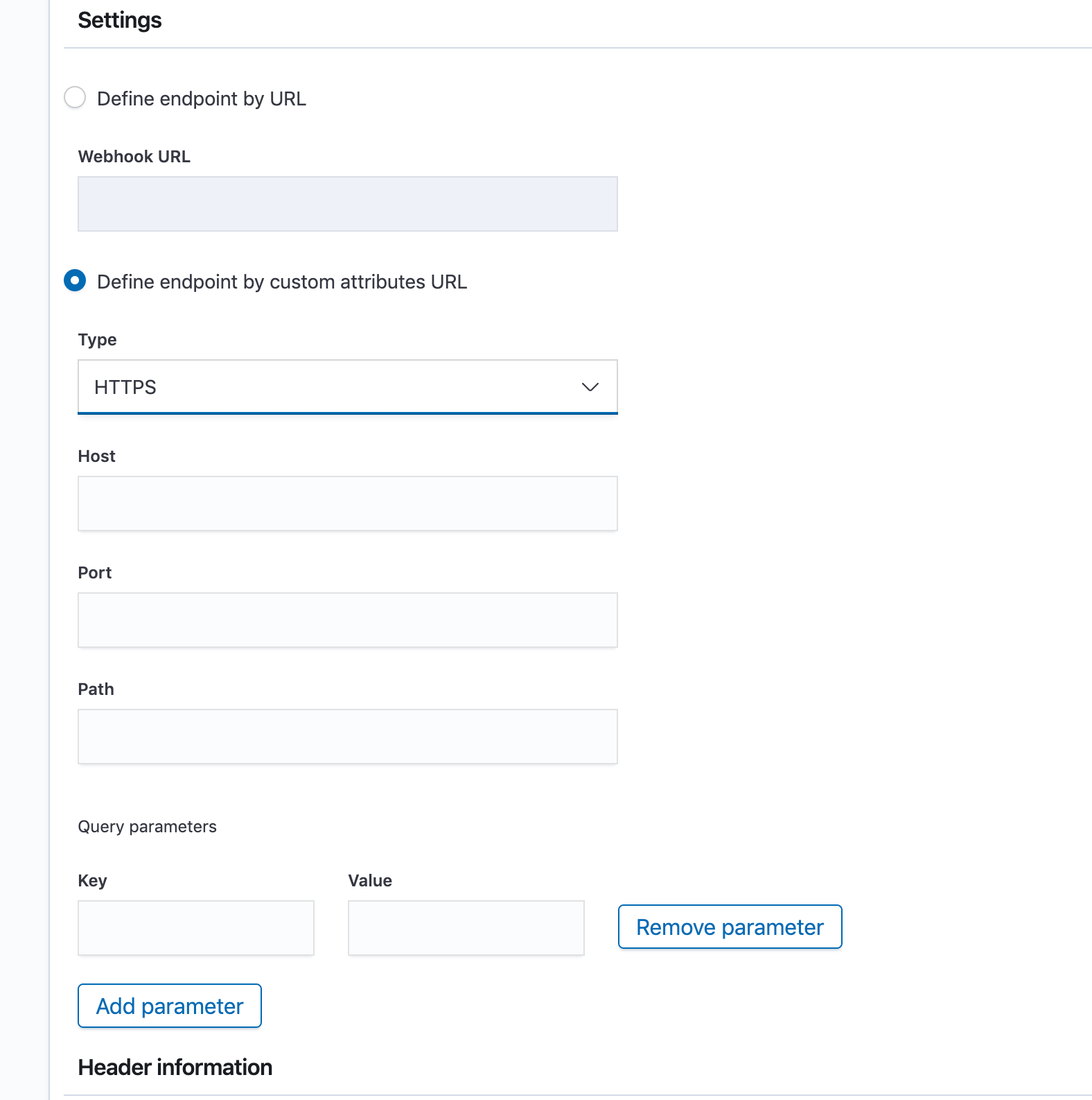

I want to forward some alerts from kibana to nagios and as a part of configuration i need to give webhook url for nagios.
I am trying to find webhook url for Nagios core 4.4.3,not sure where can i get this info.
Can you please help me if this kind fo setup is allowed with nagios?
Appreciate your help.
Thanks,
Kumar
Config Screenshot
Config Screenshot

Nagios Core doesn't have a webhook for submitting alerts. Technically you should be able to use NRDP:
https://support.nagios.com/kb/article/n ... e-602.html
See here for XML/JSON examples:
https://github.com/NagiosEnterprises/nrdp
Nagios XI makes this easy through the API (as well as having NRDP already installed) but Nagios Core doesn't have anything by default:
