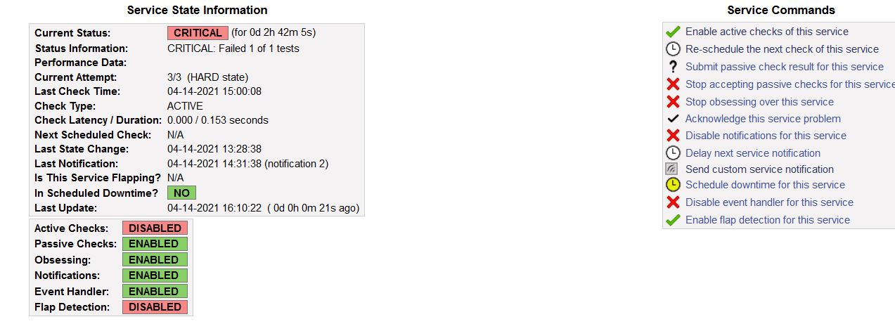

If I run the script on the server it works fine, but if I pass it to nagios it comes out as critical.
I have looked at the output value that appears in nagios and it is a 6. If I do it on the server it is 0. What could it be due to?

Status Information 6
