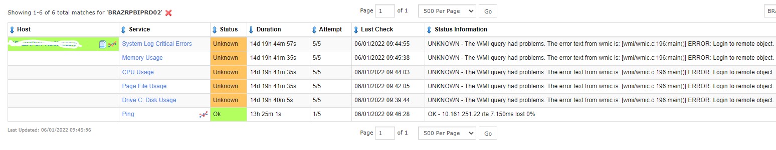

We recently tried to add a WINDOWS SERVER 2022 server to our Nagios monitoring, but we are getting the error "UNKNOWN - The WMI query had problems"
Error Nagios x Win 2022
We review the accesses and everyone is in agreement, just like other servers that work in monitoring.

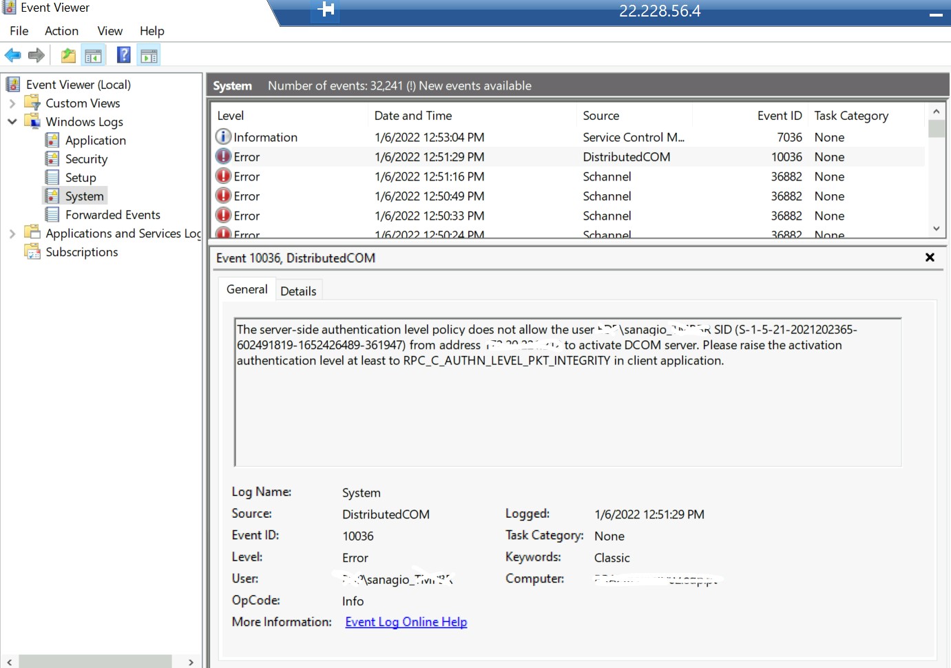

I found the log below on the win 2022 server, the user and the IP in the log are from the monitoring user and the monitoring server's IP, but I don't know how to go about increasing the authentication level or how this will help with the functioning of the monitoring in this server.
Error in server 2022

There was quite a bit of chatter on this issue in another thread:
viewtopic.php?f=7&t=63625
More in a separate thread in the customer support section of the forum:
viewtopic.php?f=16&t=63266
Post from the check_wmi_plus plugin maintainers on the issue:
https://edcint.co.nz/checkwmiplus/long- ... lus-alive/
Unfortunately, no solution beyond "switch to NCPA" or writing your own WMI based client on something like impacket. This is fundamentally a problem with the wmic client on Linux.
