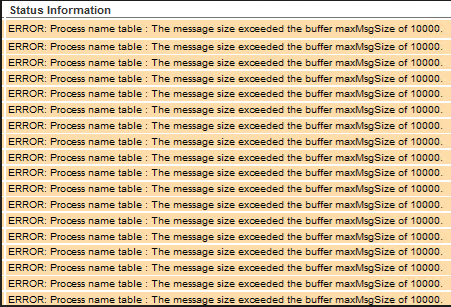

I am using Nagios Core 3.4.1 and have been having issues with alerts with status "Unknown" and the following description: "ERROR: Process name table: message size exceeded maximum buffer message size of 10000".
I have reviewed the alert settings and there are no errors in the names being monitored.
The alerts constantly change from "OK" to "UNKNOWN" status, this last status being the most common.
Could you help me to know how I can solve this problem?

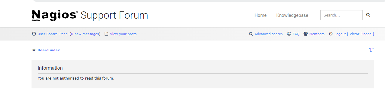

Apparently I do not have access to see the information on the attached link.
I add an image.
Regards.

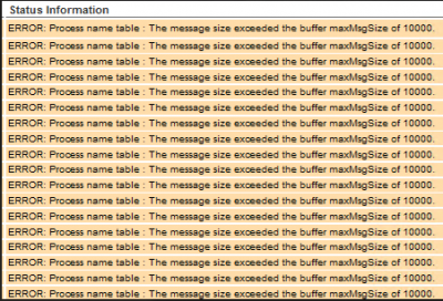

I appreciate and thank you very much for your help. I have done what you suggest but some alerts are fixed and others go from status ok to unknown
Is there anything else I could do?
