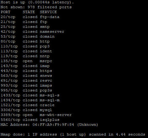

Postby priyadhole » Thu Feb 24, 2022 3:11 am
Please find the output from nagios server to windows in attached SS.

Postby gormank » Fri Feb 25, 2022 3:41 pm
Have a look at you nsclient.ini, see what the port it will listen on and check allowed hosts. That should list you nagios server addresses or subnets.
Once you know the port and have set the allowed hosts look at windows services for nsclient and verify it's running.
From a windows cmd prompt try
netstat -an | find "port number from nsclient.ini"
Then from the shell on the nagios host
nmap -p<port number from nsclient.ini> <windows host IP>
If the windows host is listening on the port, and nagios doesn't see it as open, you may have a firewall between nagios and the windows host.
Maybe try
systemctl stop firewalld
on the nagios host and try again.
