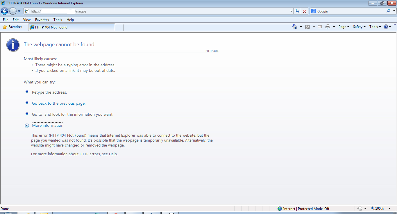

Postby devilsguest » Mon Apr 01, 2013 9:29 am
I have installed apache 2.2.24 on my linux box and have both my nagios service, Apache service up and running. But I don't see any communication between them. My page directly kicks back me to error 404 when typed the url http://localhost or ip/nagios. Conf file has no issues.....can some one help me out. Please look into the attached how the url looks like....

Postby abrist » Mon Apr 01, 2013 10:15 am
Is apache running?
ps -A | grep 'httpd'
service httpd status
Is port 80 open?
nmap localhost -p 80
Is nagios running?
ps -A | grep 'nagios'
service nagios status

Postby devilsguest » Mon Apr 01, 2013 11:02 am

Postby abrist » Mon Apr 01, 2013 11:07 am
Are you browsing to port 77 or do you have a redirect to port 77 from port 80? (i.e. http://nagios_server_ip:77)
If so, then your problem, unfortunately, most likely lies in your apache config.

Postby lmiltchev » Mon Apr 01, 2013 11:10 am
It seems like port 80 is not open. You should see:
PORT   STATE SERVICE
80/tcp open  http

Postby devilsguest » Mon Apr 01, 2013 12:05 pm
I am using port 77 to browse there are no redirect ports. I have changed the port number.Here, I am not using default port. Probably, I don't think changing port number would make a difference while browsing.
Here I have a question.....why is apache trying to extract nagios webconf file from its htdocs file? I think I found the issue but don't really know where to change the path for apache to communicate with nagios to display the home page.

Postby lmiltchev » Mon Apr 01, 2013 12:44 pm
Just curious - is SELinux enabled on this box? If it is, can you try disabling it and see if this is going to help?
setenforce 0

Postby devilsguest » Mon Apr 01, 2013 1:30 pm
did the command you sent but doesn't make any difference to my file............

Postby abrist » Mon Apr 01, 2013 1:42 pm
Post the output of the following:
Where is your config and how was it parsed?
httpd -S
Where is your "ServerRoot"?
cat /path/to/httpd.conf | grep ServerRoot
Have you declared:
Listen 77
in your httpd.conf?
cat /path/to/httpd.conf | grep Listen

Postby devilsguest » Mon Apr 01, 2013 2:00 pm
httpd -S
-bash:httpd:command not found

# ServerRoot at a non-local disk, be sure to point the LockFile directive
# at a local disk.  If you wish to share the same ServerRoot for multiple
ServerRoot "/usr/local/apache2"
Listen 77
-bash:Listen:Command not found
So I did
netstat -an | grep 77
EN
tcp        0      0 :::77                       :::*                        LIST
