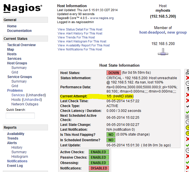

I don't have livestatus installed but do see the same in the UI.
Host
Service
To be honest, I've never noticed this before, and don't know that I would have if you didn't mention it.
I can file a bug report and have the Core developers take a look at it.

Cool. I originally saw it in the UI/XI, but was using livestatus for the report.
We discovered this by looking at the Hosts Details pages and wondering why the hosts were critical with an attempt of 1/5. We thought something was up until we saw that the state history was correct. I know that that current attempt doesn't always correlate to a hard state (ex. a service's host is down or dependencies) but this one seemed off.
