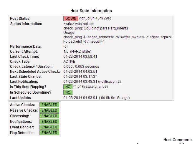

at nagios web interface i have this error ( attached pic )
Do hope there is someone who can guide me on this
Host cant be monitor wrta not set

I'm not sure where yum installed the plugins to, you will need to find the directory and point *all* of your commands to there, or remove it with yum and install from source which is what I would do personally, follow the plugin installation section here:

I followed this guide: http://www.unixmen.com/install-and-conf ... -rhel-6-4/ and ran into the same problem. It turns out it was syntax in my host config file. The sample they gave was:
Once I removed the '## CLIENT IP ##' from the address line, the issue was resolved. I believe the script is not "smart" enough to ignore the comment in the line and it breaks the command.

The Nagios core parser is smart enough to ignore comments at the end of the line, but it uses the semi-colon as the comment separator. I'd suggest that the documentation referenced be updated to say "; ### Client IP ###" instead.
Re: Host cant be monitor wrta not set
Very close. If the first character in a line is a # it is a comment, but if it is at the end of a line you use the semi-colon.
